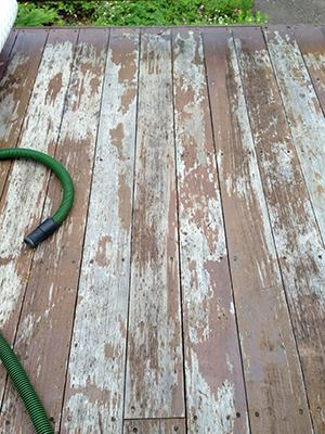

Before: Weathered and failed Sikkens coating

It was a decade or so old custom redwood deck in a harsh lakeside location with a badly failed Sikkens coating on it. The process of stripping a failed film forming coating is not for the faint of heart. Once you start, you are in it to win it.

2. Pressure Wash – Chemically Strip and Neutralize
Honestly, the use of a pressure washer and stripping chemicals is best left to professionals with a track record of success in the field of chemically stripping decks.
The chems are hot, or caustic, and can do immense damage to people and property if not understood and used with discretion.
It is sufficient for the purposes of general discussion to say that chemical stripping is a two step process: stripping and neutralizing. If both are not done correctly and safely, the job will not go well.
The fundamental process here is a fairly radical chemical reaction in which the failed coating is released from the wood surface, and the ph balance of the wood is restored during the neutralizing step.
Stripping film coatings at this level is not a quick process. It requires many passes and reapplications of chemicals, and a great deal of clean water rinsing.
3. Let Deck Dry, Then Sand
It is important to allow a day or two of good drying weather before proceeding. Premature sanding of soft wood that is still any kind of damp can tear up the grain in a hurry.
Chemical stripping of decks raises the grain of the wood pretty dramatically. This is called “furring”. For proper and even stain penetration, it is critical to remove the furring through sanding.
Depending on the size of the deck, sometimes an upright floor style sander is the most efficient method. If this is not an option, aggressive electric hand sanders are a also an option. It is time consuming, and knee pads are required. Whatever sanding method is employed, be sure that proper dust containment is used. Topcoat attaches all of its sanders to hepa filtered dust extractors made by Festool. There is too much funky dust of organic matter to risk breathing it in.
