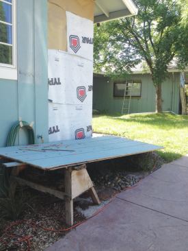

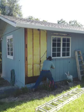

My first task was removing all the first-floor paneling that had deteriorated. We removed both the 1-foot strips and the 8-foot sheets and replaced them with full 9-foot panels. (T1-11 is available in 8-, 9-, and 10-foot sheets.)
When we removed the old panels, we discovered that no water-resistive barrier (WRB) had been installed. The building code calls for a WRB—such as 15-lb. felt, building paper, or housewrap—behind the siding. So after removing the siding for this repair, I stapled a layer of housewrap to the outside of the studs.

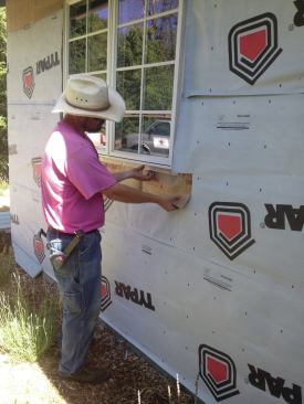

The windows were still in good shape, so we kept them in place. After the housewrap was installed, we removed the nails from the bottom flange of each window and slid flashing behind the flanges.
We installed flashing tape around the rest of the window, working from bottom to top in the usual fashion. Like a lot of the houses in this part of the country, this one had 2-foot overhangs, which go a long way toward protecting windows from moisture intrusion. Given those deep overhangs, we did not add any supplemental drip cap over the windows.

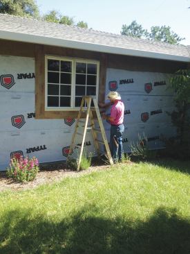

After the walls were prepped, I carefully checked the stud locations to make sure there were studs at every 4-foot interval for attaching the edges of the panels. If any additional backing is needed, it has to be done before the panels go on. I also marked out the stud positions on each sheet before setting it in place.
We started installing the panels at an outside corner of the house. To position each sheet, I set it on 2-by blocks about 1/2 inch lower than was needed. Then I used a crowbar on another block to lever the panel up and hold it in place while I drove nails in the corners.
Because the panels are installed parallel to each other, it’s imperative that the first one be perfectly plumb—that is, unless the walls themselves are not plumb.. I always tack the first two or three sheets with nails in each corner so that I can make adjustments if the panels start to run out of line.

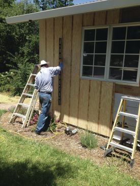

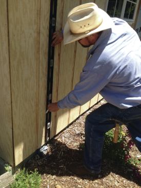

Once I was satisfied with the panel placement, I drove the tacks home and nailed off the rest of the panels with 7d galvanized ring-shank nails. A typical nailing schedule for plywood siding calls for nails every 8 inches along the edges and every 12 inches in the field, but I like to shrink the nail spacing to every 6 inches on vertical edges and every 8 inches in the field. At the stud-location marks I’d made earlier, I drew vertical lines using a long level, to guide my nail placement in the field.
I also add extra nailing along the top and bottom edges of each sheet. The “board” sections on this board-and-batten-style siding were 8 inches wide, and I drove two nails at the ends of each flat board section. These nails will prevent the siding from expanding and buckling at the grooves, and they also help to tie the top plate to the bottom plate, which is often required on an engineer’s shear schedule.
