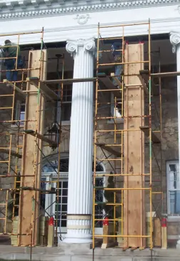

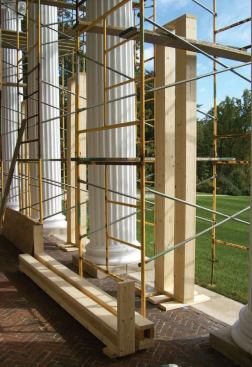

Providing Temporary Support

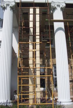

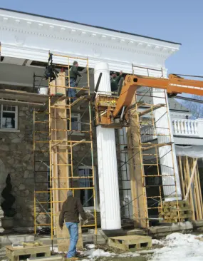

The first step was to determine how the architrave — the beam supporting the porch roof — was built. After some investigative work and consultation with a structural engineer, we devised a method of tying the beam together with framing members so that we could jack and support it as a unit as we transferred the load from the columns.

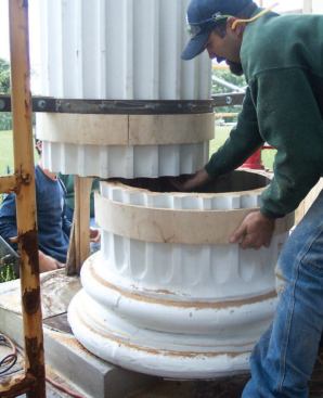

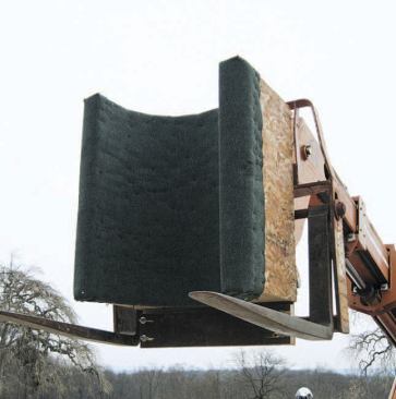

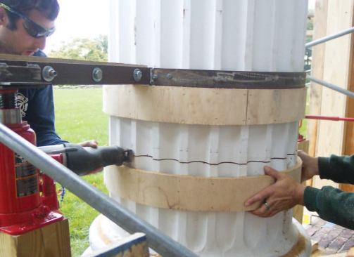

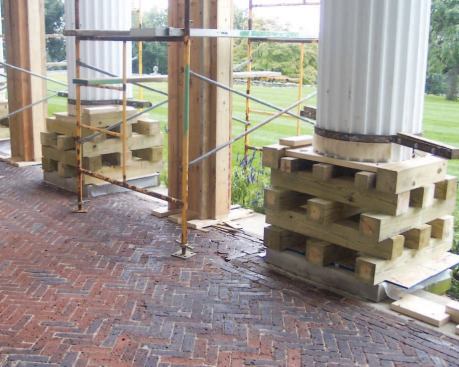

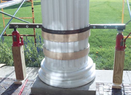

Next we built five jacking “towers” (seeslide show), on top of which we placed 20-ton hydraulic jacks. The towers would support the architrave and roof, but we would also need to hold the weight of the columns. For this purpose, we had two-piece steel clamping rings fabricated by a local metal shop By bolting these rings to the column above the cut line, we could safely support the columns while we worked on them. Once the columns were cut off and the bases removed, we planned to make templates for the replacement sections by tracing around the flutes. We would then block up the shortened columns until the new bottoms arrived from the millwork shop.
Best-laid plans. With two jacks per tower, the architrave and roof lifted easily, as did the columns. Cutting the columns proved more difficult. After making saw guides from bending plywood, we started in with a Big Foot wormdrive saw, hoping its 4-inch cutting depth would allow us to cut through in one pass. However, as we began to cut, the saw began to bind — it felt as though the inside staves of the laminated column were coming apart. We drove screws through from the outer layer into the inner layer, tying everything together. We abandoned the Big Foot and instead used a standard circular saw, finishing the cut with a recip saw.

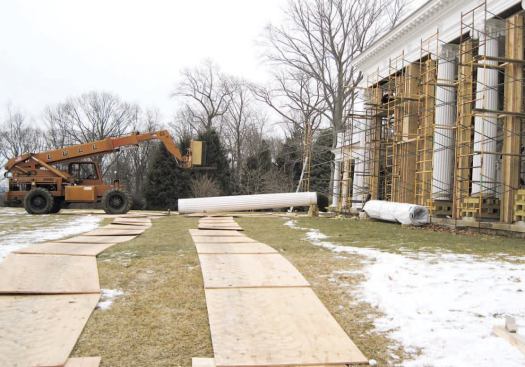

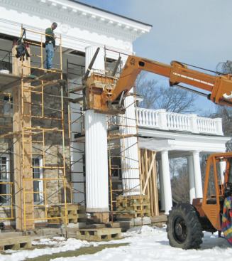

Once the first column had been cut completely through, our suspicions were confirmed: The inner staves were delaminating because the glue was failing. The engineer advised that the columns would have to be replaced. We cut and cribbed the remaining columns and suspended the job while the homeowners decided how to proceed. It was the end of September 2009.
