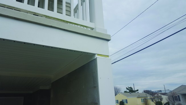

One of the condo owners discovered water  pouring out of the aluminum capping that covered a beam above his second-floor balcony.
On a recent project that was typical of a lot of the structural repairs we do along the southern coast of New Jersey, we encountered serious rot in many of the dimensional and engineered wood beams. The beams were not detailed well for protection from the driving coastal rains we encounter in this region. It’s a tough environment for wood: Not only do we get lots of wind-driven rain, but the ocean air is high in humidity year round. When wood doesn’t have a chance to dry, it will rot quickly—and engineered materials with all their adhesives are no exception. Waterproofing for these conditions is not just about deflecting water away from the building; you also need to create a way to drain the building assemblies and allow air to flow over the wetted structure to promote drying.
The Problem

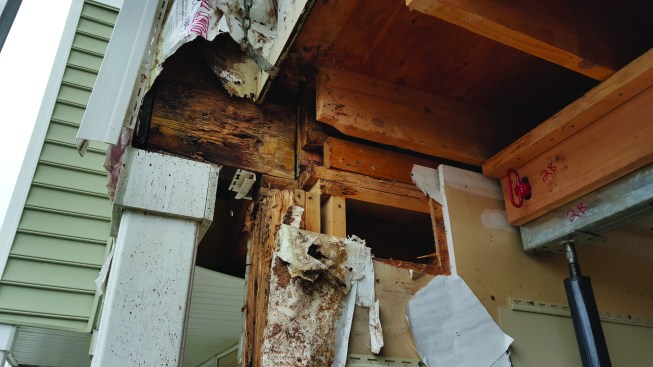

The problem was originally discovered by one of the condo-unit owners, who saw water pouring out of the aluminum capping that covered a beam above his second-floor balcony. We were contacted to investigate the leak and discovered mold and rot in the beam under the capping. The balcony on which we were standing was supported by a similar beam, in the first-floor ceiling of the carport. We also removed the cladding from this beam, and discovered similar conditions.

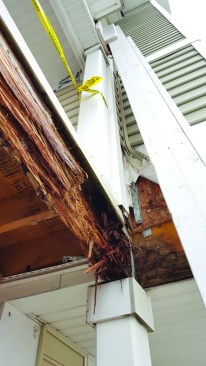

We were called-in to investigate, and quickly discovered mold and rot in the beam under the capping.
The deterioration to beams occurred throughout the condo complex.

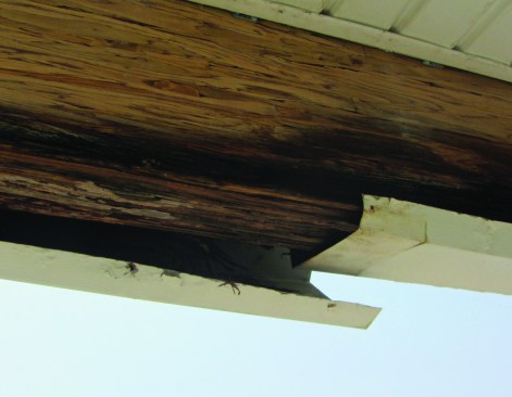

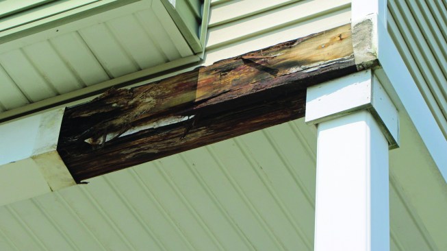

The beams were clad with aluminum trim coil that was trapping water at the bottom of the assembly. Bad as that detail was, it might have been all right if the top of the beams had been protected, but that was definitely not the case.

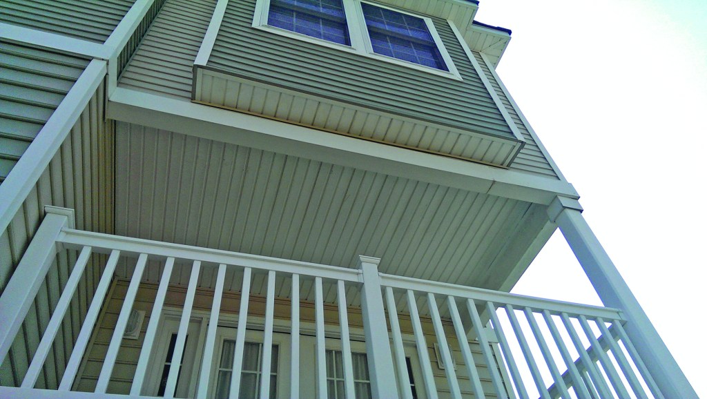

The second floors of the buildings have a decorative band around the perimeter that forms a break in the siding and consists of a 2×8 capped in aluminum trim coil. Where this band passed in front of the beams, it was applied over the sheathing and housewrap. This allowed water into the trough created by the capping under the beam.
Aluminum capping had been applied over the beams, creating a trough and holding water that leaked in from above.
Some of the lower beams had OSB sheathing on the front of them, which made them protrude past the front edge of the fiberglass balcony. This allowed the water running off the balcony to flow directly into the capping. All the buildings lacked gutters, as well, so when it rained, roof runoff flowed straight down the vinyl siding.

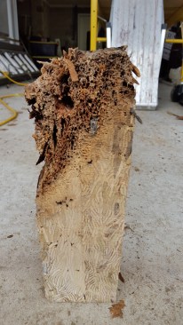

There is a myth that all the adhesive in some types of engineered wood means they are less prone to rot. Not so. Here, an untreated Parallam beam that was extracted from the building shows just how rotten the bottom of an engineered beam can get from sitting in a trough created by poorly designed aluminum capping.

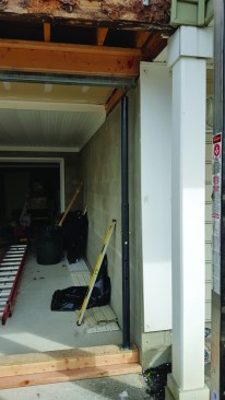

On previous projects of this type, we constructed temporary 2×4 walls under every beam we replaced, to support the floor load above. This was time-consuming and produced a lot of waste. The temporary walls were also very intrusive, limiting access and work space.
For the temporary support system, we utilized a bottom beam to distribute the load across the floor, adjustable Lally columns, and an adjustable support beam across the top.

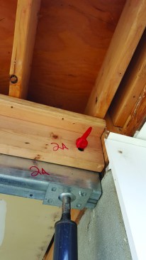

To avoid this frustration, we recently started building modular supports, which have worked great. These consist of a bottom beam to distribute the load across the floor; adjustable Lally columns; and an adjustable support beam across the top.
The bottom beam is a 2×12 plate with a 2×4 on edge making an upside-down T. Over this, we put an upside-down U made with two 2×4 sides and a 3/4-inch-plywood top. Essentially, we have three 2x4s for bearing on a 2×12 plate, but the assembly is sectional, so it’s not too heavy to move from job to job.
The top support beam is made with light-gauge steel that fits into an upside-down-U pocket consisting of a 2x12 plate and two 2x6s on edge. We drilled slots in the 2x6s and a hole in the steel beam for a pin, which allowed for adjustments in height.
The top support beam is made with light-gauge steel that fits into an upside-down-U pocket consisting of a 2×12 plate and two 2x6s on edge. We drilled slots in the 2x6s and a hole in the steel beam for a pin, which allowed for adjustments in height.
The top support beam is made with light-gauge steel that fits into an upside-down-U pocket consisting of a 2×12 plate and two 2x6s on edge. We drilled slots in the 2x6s and a hole in the steel beam for a pin. The top plate is screwed to the ceiling framing, and then the beam is slid in and hangs until the posts are installed. For this project, the posts were set at just under a 12-foot span. We have a third pole for the center if needed to support loads across longer spans.

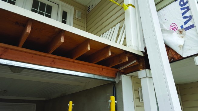

After removing the aluminum capping, siding, and soffits, we discovered that much of the surrounding sheathing and some of the framing was also compromised. We had included most of this in our scope of work, as we had assumed that if the beams were wet, the areas around them would be also.
As expected, after we removed the aluminum capping, siding, and soffits, we discovered that much of the surrounding sheathing and some of the framing was also compromised.

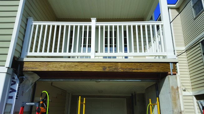

Fitting the new beams was challenging, but we made good use of our adjustable support columns to lift the structure and gain room for the new beams.
Once we had a clean space, fitting the new beams required some finesse. The old beams had compressed at their bearing points, and the new beams did not always have the necessary clearance. But this is where the adjustable columns used for our temporary supports came into play and made the job simple: We were able to slightly lift the structure with the screw jacks to gain the space we needed.
Ready to take down the temporary supports
Once the new beams were in place, we partially loaded them before nailing them off and removing the temporary supports.

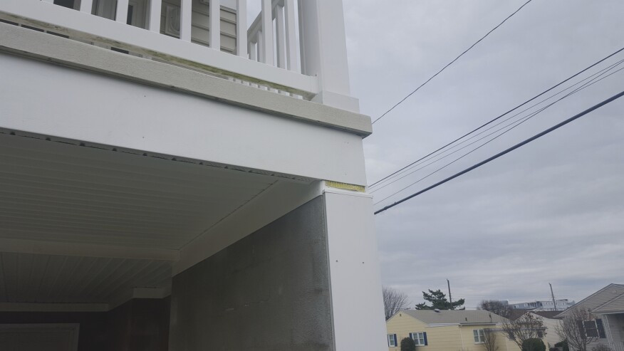

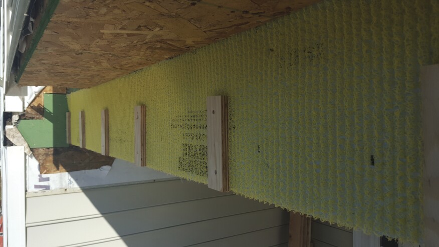

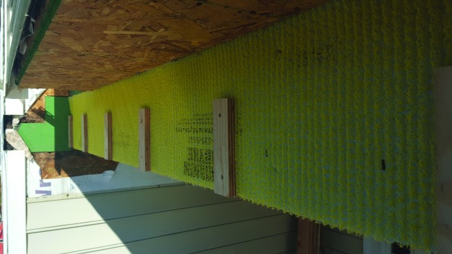

We installed Home Slicker, a matrix-type rainscreen, to the exterior side of the beam. Then we then installed 2-inch-wide strips of 3/4-inch marine plywood before attaching a 2x8 band.
We installed Home Slicker, a matrix-type rainscreen, to the exterior side of the beam. Then we then installed 2-inch-wide strips of 3/4-inch marine plywood before attaching a 2×8 band.
To protect all the new beams from water and prevent a repeat of the rot, we installed Home Slicker, a matrix-type rainscreen, to the exterior side of the beam. We then installed 2-inch-wide strips of 3/4-inch marine plywood before attaching a 2×8 band. This assembly allows for unrestricted water flow for rainwater or snow melt that makes its way past the siding and flashings, and it provides plenty of room for air flow for drying.
On the bottom of the beam, we installed vented soffit to allow water out and air in, and for both the exterior and interior sides of the upper beams, we used L-shaped bends of aluminum capping.
On the inside of the beam, we installed Tyvek housewrap to isolate the aluminum trim coil from the pressure-treated beams. On the bottom of the beam, we installed vented soffit to allow water out and air in; and for both the exterior and interior sides of the upper beams, we used L-shaped bends of aluminum capping. On the exterior, we installed a Z-bend that was taped to the sheathing under the housewrap and bent over the top edge of the band board. This will force any water that makes its way behind the siding to the outside above the beam. On the lower beams, the capping was slid between the fiberglass fascia and the beam to limit water getting between the cladding and the beam.
