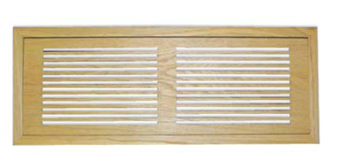

When an hvac grille has to be moved from the wall to the floor, you can buy a cheap metal grille at any home center, or you can class up your project with a hardwood grille to match the flooring..
The exposed vent apparatus is usually a louvered metal contraption with a lever that sits proud of the floor and thus is easily mangled. Beneath a window, where there’s limited traffic, the lever is fairly safe. In front of a door, however, a flush-mount unit is necessary. If there’s carpet, set it on top of the carpet. For wood floors, the right thing to do is match the species and stain the grille before installing it. I use Cape Cod Air Grilles (800/547-2705; ccairgrilles.com).

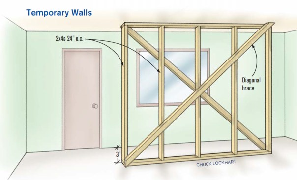

Before any structural work is done, the author wedges in a temporary wall built from 2x4s. Placed about 3 feet from the outside wall to provide working room, the temporary wall supports the load from above. Carpet scraps pad the wall’s top and bottom to minimize damage to the flooring and drywall. The temporary wall can be wrapped in plastic sheeting to help contain the dust.
Chuck Lockhart
Open the Wall
Before cutting into the wall, I build a temporary stud wall, usually 8 feet long, of 2x4s 24 inches on center. To protect the ceilings and floors from damage, I wrap the top and bottom plates with carpet samples, then wedge the temporary wall in tightly between the floor and the ceiling to prevent movement. It will probably leave marks on the drywall, but guess what? You’ll be painting anyway. If you’re lucky, the homeowner has some touch-up paint stashed away. If not, save a scrap of the drywall you remove for color matching at the paint store.

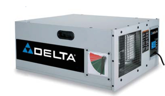

An air cleaner such as this Delta unit is intended for small woodshops but does a good job minimizing the dust inside your client’s house.

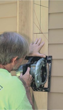

When the siding is wood, I make as much of the cut as possible with a circular saw, first removing any nails in the saw’s path. If anything, set the depth of the cut a little shallow. I’d rather have to finish the cut with a knife than cut into the housewrap. To make the straightest cut possible, I screw a shooting board to the wall (see sidebar). Before cutting, I score the siding with a knife along the shooting board to minimize chipping.
To finish the bottom of the cuts, I use a combination of a Japanese pull saw, an angle grinder, a RotoZip, and a reciprocating saw — whatever works. Prime the freshly cut edges of the siding; doing so will make a world of difference in how long the paint around the door will stay on the wall.

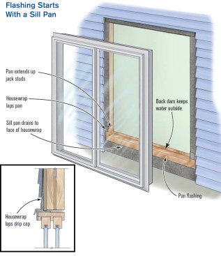

The lowest part of flashing is installed first — here, a sill pan. Housewrap laps the sill pan; then, install the door so its side flanges lap the housewrap and the housewrap laps the top flange. All seams are taped. If trim is to cover the flanges, add a drip cap to its top.

The first step is to install pan flashing on the floor so it drains to the face of the housewrap below (Figure 6). You can bend sheet metal to make the pan, sealing the corners with a bituminous membrane such as Grace Vycor (800/354-5414, graceconstruction.com) or BT25XL (Protecto Wrap Company; 877/271-9661, protectowrap.com). You can also make the entire pan from one of these membranes or use a manufactured pan.

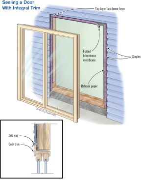

A way to flash a door with integral trim is to adhere bituminous membrane to the housewrap, folding it so the other edge faces the back of the trim. To do this, slit the release paper, remove it from the side of the membrane that will contact the housewrap, and apply the membrane to the wall. Fold the membrane, staple it in place, and remove the remaining paper.
