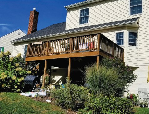

Our client in Maryland had an old, decrepit deck that needed—at minimum—rejuvenation. Upon inspection, it was deemed beyond repair. Deciding to proceed with a full replacement, the client was vehemently opposed to composite decking and adamant about using ipe.

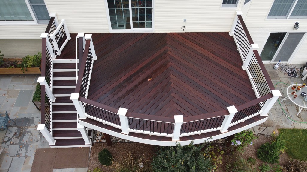

We wanted to use only full-length boards, eliminating unsightly and potentially hazardous butt joints, so we opted for a herringbone pattern with an outward spray that gives a visual illusion of a larger deck. We then dressed the deck up with a soft curve on the front.
The client opted for white rails to contrast with the dark, oiled wood. Large, 6×6 rail post covers enhance the appeal of the cocktail rail while black round balusters open the westward view of adjacent farm fields and beautiful sunsets.
We used ProWood critical structure treated lumber to create a substructure having a longevity commensurate with the Brazilian walnut decking.
