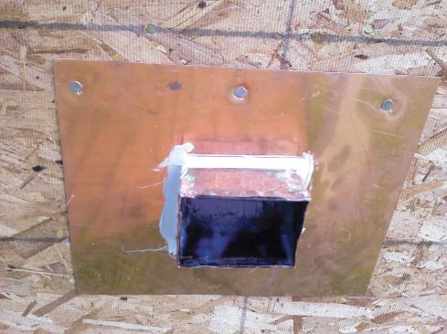

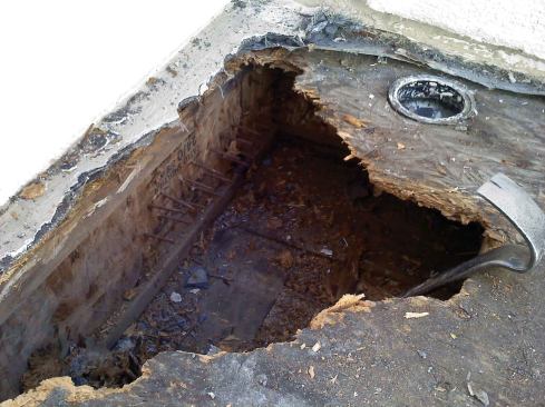

The first slideshow photo shows significant damage to wood framing from water intrusion at a through-wall scupper. Poor or missing details—including a lack of exterior counterflashing over the scupper and poor installation of the weather-resistant barrier—allowed water to leak in from the exterior side. In addition, the scupper was initially installed with the drain-end of the tube higher than the deck. This caused water to pool in front of the scupper, and eventually that water seeped in past the poorly applied deck coating and around the scupper.

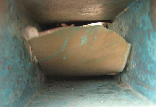

For this repair, the customer insisted on our using copper flashings. We will use copper only if requested and only if the clients sign a waiver against coating failures, because even when copper is installed correctly, coating failures are possible. The characteristic green tint that makes copper so attractive for finish applications forms when acids in rainwater and pollutants in the air come in contact with exposed copper surfaces. This reaction happens even more quickly in salt air. The patina eventually creeps under the polymer waterproofing and causes it to debond.

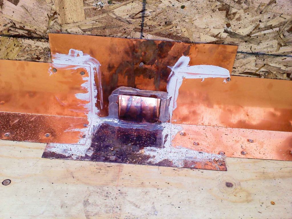

Regardless of the flashing material chosen, it’s critical to integrate the scupper assembly with L-flashings and the deck waterproofing materials. Note that the L-flashing laps over the scupper flanges and that these laps are bedded in a polyurethane caulk.
Prior to applying our primer and waterproof top coating, we sand the interior of the scupper to promote adhesion of the coatings to the metal. This prevents the coating from debonding as the copper oxidizes, as it has on the scupper in photo. We then prime the scupper and lap on a cementious or epoxy waterproofing when we finish the deck. Coating a copper scupper with the decking materials isolates it from air and water, helping to prevent the reaction that takes place with uncovered copper. But the copper is still vulnerable at exposed edges, which is the reason we require a signed waiver.

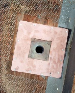

We counterflashed the exterior side as a best-practices method. We nailed it at the top, but not at the bottom so the contractor installing a water-resistive barrier can slip that layer under the shield and trim his paper down over the front of the shield, providing a highly leak-resistant barrier.

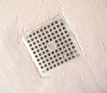

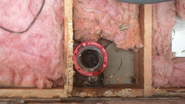

Leaks at drains often occur because the original contractor had used the wrong assembly, such as a toilet closet flange or a plastic shower drain. Neither type can be integrated with deck waterproofing materials. Instead contractors usually just pump a lot of caulk around them and hope for the best. Eventually they leak.
We replaced both of those drains with commercial deck-drain assemblies, like the ones from Thunderbird Products (thunderbirdproducts.com). The wide copper flange can be integrated with layers of waterproofing, and because this flange is never exposed to the elements, it won’t oxidize, so the polymer bond stays intact over time.

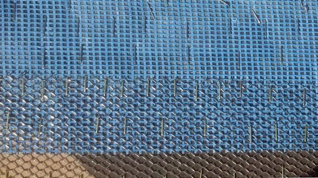

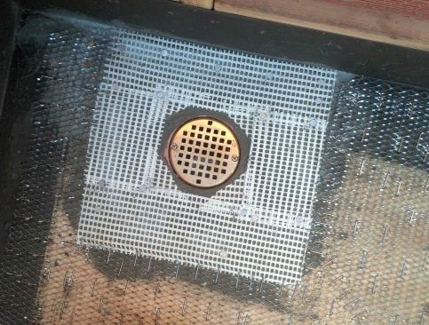

To prevent galvanic corrosion, care needs to be taken to isolate the copper flange from the metal lath that is commonly used with cementitious waterproofing systems. The copper flange is first coated with primer—a diluted mix of the polymer additive used for the cementitious waterproofing. Then we cut and fit metal lath around the flange without allowing the two metals to touch. We bridge between the flange and lath with glass fiber reinforcing mesh, such as Dryvit’s Panzer mesh. If bonderized steel L-flashing laps the copper drain flange, the two metals should be separated with a peel-and-stick membrane. Ideally, L-flashings should lap over the drain flange, but in retrofit repair work we will sometimes compromise if the existing flashing is in good condition and we feel we can successfully waterproof it.

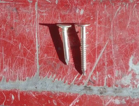

We secure the lath and reinforcing mesh with 1-inch-crown stainless steel lathing staples. We nail-off the flange with 1 1/4-inch stainless steel ring-shank coil gun roofing nails, which provide considerably more holding power than the cheaper smooth-shank roofing nails. Stainless fasteners are hard to find in my area; we order them online as we need them from Fastener USA (fastenerusa.com).
