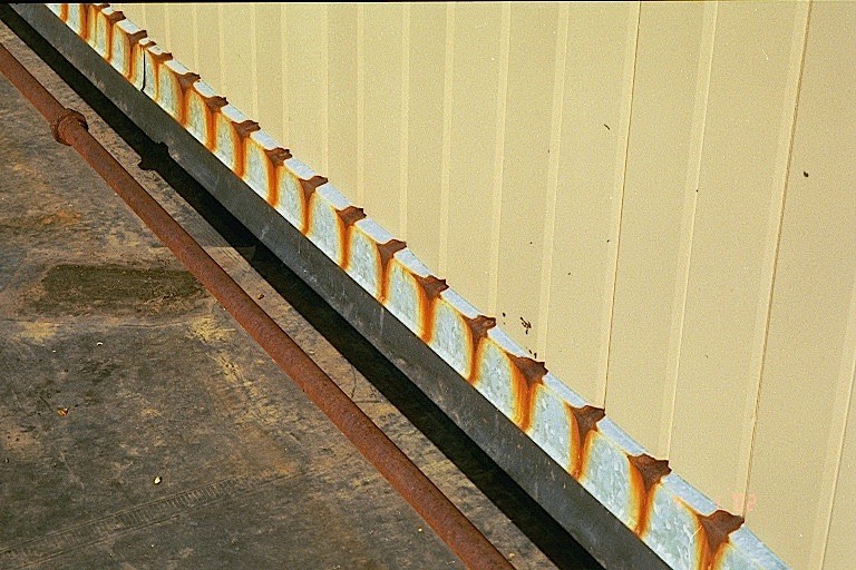

Painted metal siding panels in contact with galvanized metal flashing provides a good example of how dissimilar metals can react. The coating on the vertical panels provides protection to a point, but the differential movement of the siding panels has worn that coating off at every joint. In the presence of water, the exposed metal of the siding has reacted with the more active galvanizing on the flashing, creating a pattern of rust spots on the flashing.

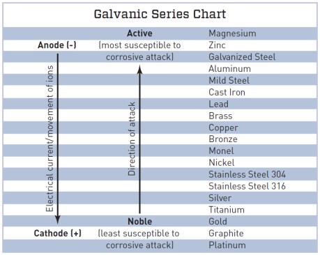

A technical explanation of the process is that metals contain atoms and ions that may provide negatively-charged anodes (known as anodic) or positively-charged cathodes (known as cathodic). When two different metals come in contact in the presence of an electrolyte—in this case, water—a small electric path moves from anodic (more-reactive metal) to cathodic (less-reactive metal). Over time, this electron transfer leads to degradation or corrosion of the anodic metal while the cathodic metal stays relatively unaffected. Looking at the chart below (based on a chart at solarprofessional.com), you can get an idea of how different metals used in construction compare to one another in regards to their level of galvanic activity.
This chart lists common metals in order of how reactive they are with other metals.The greater the distance between two metals on the chart, the greater the potential for corrosion when they’re in contact.
As a general rule, it is probably good to physically separate different metals, just to be safe. That separation, or isolation, can be done with paint (although metals rubbing together over the years might cause paint to wear off), with some sort of plastic film (which might become brittle and deteriorate over time), or with a self-adhering rubber or asphalt-based membrane (such as Protecto Wrap flashing tape; protectowrap.com). These self-adhering membranes can be found in most residential construction supply houses. Also keep in mind that even if one of the metals involved has factory-applied paint, the ends and edges of the metal can be difficult places to maintain any protection.

I often see buildings like the one in the photo with prepainted vertical metal siding in direct contact with galvanized counterflashing, and rust forming on the counterflashing. That is because the galvanizing itself is metal and it’s reacting negatively with the siding, which is a different metal. Most likely, cyclical and differential movement have rubbed the finish off the siding at those places where adjacent panels meet. The newly-exposed metal in the siding consequently attacks the galvanized finish of the counterflashing at each of these locations creating a regular pattern of rust spots.
Time and water are always the culprits with galvanic reactions. Adding a protective coating like paint to metal can forestall corrosion, but in your case, installing aluminum rather than copper gutters might better reduce the risk of corrosion.
