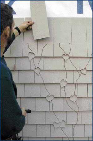

Though simple to install, a vine-and-leaf design offers plenty of room for creativity. You can lay up a single vine or let it branch in several directions; the design can "grow" up the entire wall or just partway.
Vines are installed as the field shingles are being installed — one course at a time. I start by sketching out a route for the vine on the housewrap. Even though part of this sketch is covered as each course of shingles is applied, it's easy to retrace the route by eye as the courses go up.
Vines — which are simply slots cut into the exposed part of shingles — can start anywhere on the wall, and terminate either by dying into a soffit or by narrowing over two or three courses and then curling to an end, just like a natural vine.
Personally, I think the shadow lines alone create plenty of contrast, but to highlight the design, some clients like to paint or stain the vine brown and the leaves green.
To form leaves, I trace the outlines of precut patterns onto shingles, then cut out the design with a jigsaw. While not every shingle course needs to have a leaf, I do cut a vine into each course to continue the design.

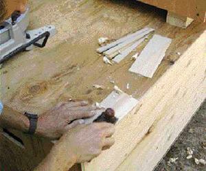

Ramp shingles. I use ramp shingles whenever I need to blend overlaying shingles back down to the level of the field shingles.
I rely on two types of ramp shingles: sideways shingle ramps and planed ramps.
To make sideways shingle ramps, I simply rip a full shingle lengthwise into 1-inch-wide strips. Although I typically do this on a table saw, it can also be done easily with a utility knife.
To make a planed ramp, I use a block plane to bevel the face of the shingle so that one outside edge is about 1/16 inch thick.
Another way to ease the transition from one level to another when installing decorative shingle patterns is to taper the edge of the shingle with a block plane.
For more complex designs, I often use combination ramps, especially when ramping a layer over a full-thickness shingle undercourse. Rather than planing a 3/8-inch shingle butt to a featheredge, it's easier to plane it to just 1/4 inch to 3/16 inch and then apply a sideways ramp to the bottom edge.
To make undercourse and ramp shingles, I always save shingle cutoffs from previous sidewalling jobs.
After installing the ramped undercourse, I select a field shingle to cut the vine slot through, mark (in chalk or faintly in pencil) a square line across the "vine" shingle at the next exposure above, and sketch the route of the vine in chalk.
Marking the route for the vine.
The author uses a jigsaw to cut the vine slot to a point just beyond the exposure line.
Extra fasteners at the vine slot help prevent the shingle from splitting.
Next, with a jigsaw or coping saw, I cut out the vine slot, making parallel cuts to establish the width of the vine up to a point 1/4 inch above the exposure line. While I do this, I'm careful to brace the shingle well to avoid splitting it. Before fastening the "vine" shingle to the wall, I sand and prime (or stain) the cutout slot as necessary, then add an extra fastener on either side of the slot.
