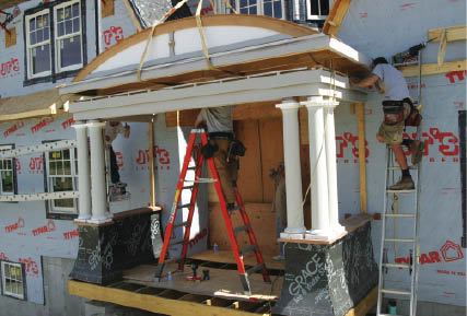

That’s how we handled the front entry featured here — an arched-roof portico projecting between gambrel gables above a rounded deck. The front corners of the roof rest on composite columns standing on flared-skirt half walls. The gambrel eaves terminate on the portico roof, creating as complicated a junction of rooflines as you’re likely to encounter.
When I began the job, only the height and depth of the entry inset had been established on site, but the window immediately above the portico roof had not yet been framed. So to play it safe, everywhere that the porch assembly would join the main structure, I allowed 1 1/2 inches of clearance for fitting and shimming. We also had the site crew hold the adjacent roof framing back a couple of feet until the portico roof could be dropped into place.

With a crane standing by, we loaded the components on a flatbed trailer and towed them to the site. We first lifted the deck frame into place, leveling and shimming it, then bolting it to the building with LedgerLok screws (800/518-3569, fastenmaster.com). The base plates for the half walls were already screwed to the deck frame in the shop. I patterned their locations directly from the architrave, ensuring accurate alignment with the column plugs overhead. All we had to do was to lift the two walls off the truck and fit them onto the base plates. We then lag-bolted the walls from underneath, through the base plates.
The composite columns went in next. We set them on the railing cap and screwed them to the blocks. The plinth bases slipped down to cover the connection.
We had added secondary fascia trim to the architrave in the shop, to cover Cor-A-Vent strips (800/837-8368, cor-a-vent.com) that provide ventilation. The ceiling was left open, to give the electrician full access for wiring and lights. We would install the beadboard later, on site.
After we screwed the column tops to their corresponding cedar plugs on the architrave, we were ready to lower the roof sections into place. We installed the front section of the roof first, carefully lowering it so that the trusses dropped in between the vertical hold-downs protruding from the architrave. The rear section of the roof required some scribing before it could drop into place. We then completed the roof sheathing between the two sections by gluing and stapling stepped layers of precut sheathing at the joint.
The entire installation took less than a day, start to finish. Total shop time ran about 250 man-hours. With the portico in place, the framers completed the abutting roof lines and added crickets to either side of the angle bay. The roofing contractor finished the portico roof with lead-coat copper flashing and an EPDM membrane.
