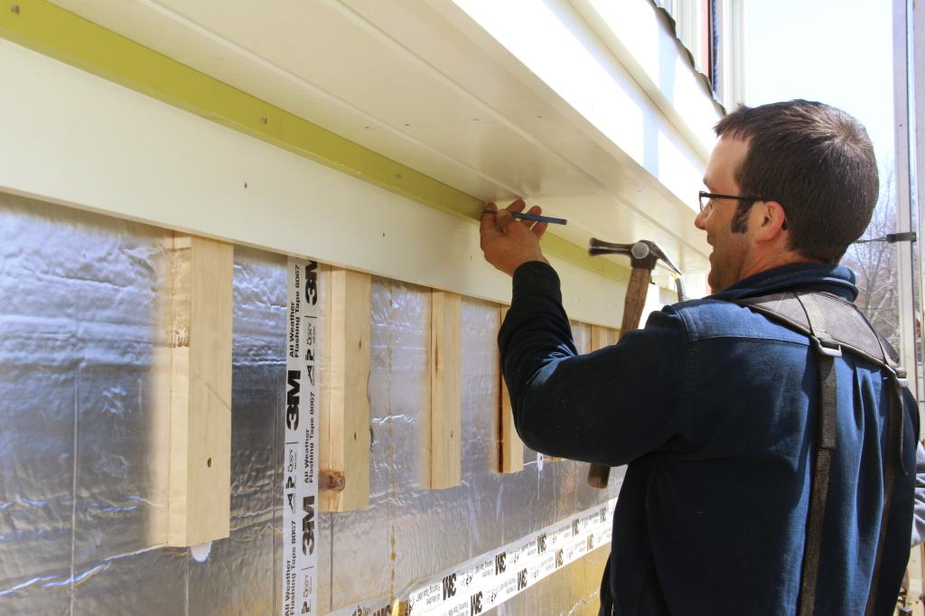

As a final touch, Pollards fastens pre-painted bed molding is over the frieze, setting the nails flush to the surface of the trim. The whole trim package will get a final coat of paint once the siding is complete.

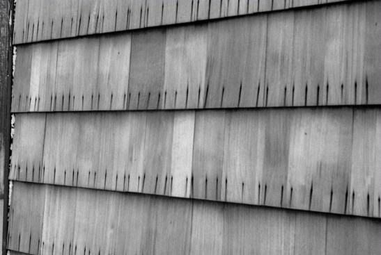

Bleeding is caused by excessive moisture in siding, which reacts to the iron in nails. The staining is caused when a high moisture content in wood dissolves the wood’s naturally occurring extractives — pigments, tannins, oils, and resins. To prevent bleeding, keep siding dry before installation. Back-prime to help seal extractives in the wood, and install the siding on a rain screen to promote drying. Seal or paint the wood when it is dry and maintain the finish to keep wood dry over time.
