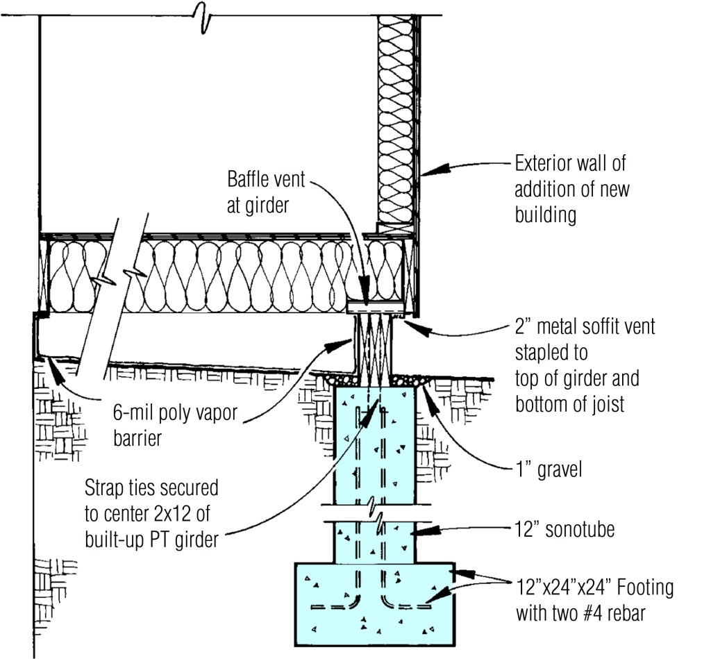

For most decks, porches, and small additions, a simple pier-and-grade beam will suffice.
A big advantage of piers with a pressure-treated grade beam is that this foundation can be installed without disturbing existing utility lines.
For sizing pier diameters for small foundations, the rule of thumb is “1 inch per foot of span.” Thus, a deck that spans 8 ft. will stand comfortably on 8-in.-diameter piers, while a deck that spans 10 ft. requires 10-in.-diameter piers. For spans longer than 12 ft., add a second row of piers and a second girder at the center of the joist span.
For calculating concrete amounts, see Estimating Concrete for Piers.
