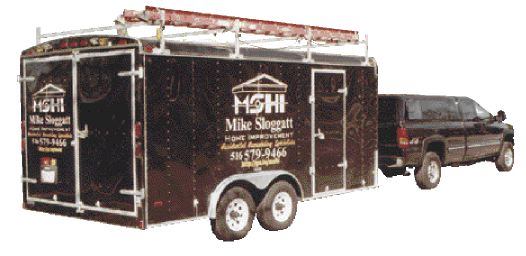

I bought a 16-foot, dual-axle Haulmark (800/348-7530), with 6 1/2 feet of arched headroom and an 8-foot-wide cargo area. I pull it with a Chevy C-2500 4×4 Duramax Diesel. The trailer, empty, weighs 2,900 pounds and is rated for a 7,000-pound payload with its optional heavy-duty axles. Oddly, the trailer came equipped with a hitch rated for a measly 6,000 pounds gross weight, so I had to immediately spend an additional $300 for a heavier-duty, 12,000-pound-rated weight distribution hitch.
Built-ins. I set up the interior for production, with a 10-foot sheet-metal brake on a long workbench along one side, and a drop-in miter saw centered on a bench on the opposite side (see Figure 1). A shop-vac under the bench, ported to the miter saw’s exhaust, keeps the bench clear of sawdust. Even on a rainy day, I can usually keep something going on inside the trailer. On sites where power isn’t readily available, I’ve got a battery backup feeding a power converter. And, conversely, I’ve got an external hookup so that I can power the trailer from a job-site source. Above and below the benches, I installed storage bins and shelving, using hollow aluminum extrusions for uprights to add strength and keep the dead weight down. Most of the bins lift out for easy transport of parts and equipment. Many of our most frequently used tools hang from quick-release carabiner clips at the front of the bins, so they can be seen easily and returned (Figure 2). The clips also keep the tools hung during travel — like a boatbuilder, you have to keep the effects of swaying, rocking, and bouncing in mind if you don’t want to find everything on the floor by the time you pull up on site.

Job-site pilferage, in the form of grand-theft auto, is, unfortunately, a distinct possibility where I work. Seeing all of my equipment in one place and ready to roll could be more temptation than an enterprising thief could resist. I considered installing a motion-sensing alarm, but too many nonevents, like a strong gust of wind, could set it off. Also, if the trailer does embark on an unauthorized trip, I want it back as quickly as possible, before it can be stripped. For peace of mind, I purchased InterTrak (866/346-3631), a satellite tracking alarm system, for the trailer. Now, if it moves even a few yards after hours or any attempt is made to intrude, I get an immediate alert on my pager and cell phone, and the security company can home right in on its physical location. The service costs less than $20 per month.
A trailer this size is somewhat challenging to position and park, especially after dark. I upgraded the back-up lights to provide bright illumination and installed a set of warning strobes, mounted above the rear doors, for safety.

Signage loophole. A real added benefit of the trailer is the billboard-sized graphic I’ve got painted on the sides and rear doors. The township where we do most of our work doesn’t permit any signs to be posted on the job site. But there’s no regulation against vehicle signage, and there’s no way to miss seeing mine when it’s parked on the job.

All told, I’ve invested a little under $11,000 to buy and customize the trailer. I’d do a few things differently if I were trailer shopping today. The side panels are a light-gauge metal, which, although adequate, gives the trailer a slightly flimsy, quilted appearance. Heavier side panels are an available upgrade option — I’d have spent the extra couple of hundred dollars if I had appreciated the difference at the time. More seriously, the roof panels aren’t made to be walked on, which is truly inconvenient considering the otherwise ample roof-rack storage that’s available. Reinforced framing and roof panels, to support our weight, would make loading and unloading materials 8 1/2 feet off the ground a lot safer and easier.
The floor frame comes standard with 2-foot on-center steel tubing; instead, I opted to have the frame built 16 inches on-center to stiffen the floor. However, I ended up laying strip oak flooring over the stock 3/4-inch plywood to provide a durable work surface. Two-foot centers would easily have handled this floor system — as it is, the extra steel adds a few hundred pounds to the rig.
