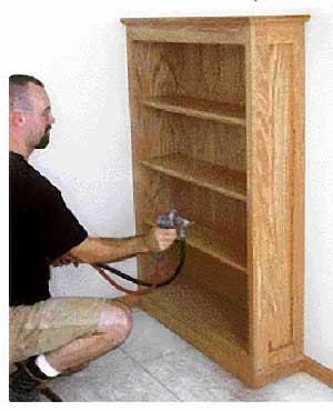

Spraying
Once the cleaning and prep-work are done, spraying is a relative breeze. I plug in the compressor, attach an in-line filter to catch any debris or moisture coming from the compressor, hook up the pot, and try to situate the equipment in the room so that there’s little need to move anything but the gun. I always work back toward the compressor, so that I can periodically retrieve the hose without any risk of dragging it against a wet surface. On the regulators, I typically set the air pressure at around 30 psi and the fluid pressure at around 7 psi. That seems to yield the best pattern and the best results on base trim.
When I’m done spraying all the narrower pieces, I simply increase the amount of fluid and widen the pattern at the gun for doors and built-ins. A dual regulator setup on the pot eliminates the need to mess with the settings on the compressor itself, which are far less accurate than those that come on a pressure pot.
