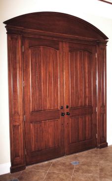

I'm an independent painting contractor, and do most of the finish work for Gary Striegler, a builder in Fayetteville, Ark. He built the entryway featured in this article - a pair of mahogany doors framed by built-up door casings and an arched pediment - using birch plywood panels, a combination of pine and poplar moldings, and poplar trim stock (see sidebar).
Mixing wood species isn't a problem when trim gets a high-quality paint finish, but under a clear finish the color variations become too obvious to ignore. Over the years, I've found ways to cost-effectively color-match the various substrates Gary uses in his trim assemblies; then I give the trim a furniture-like finish on site.

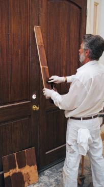

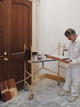

Color. On this project, I wanted to match the color of the stained and sealed doors. In other cases, the general contractor or client may have a specific wood color and shade in mind - light or dark, brown or red, or something else. Either way, sample boards are critical to the color-matching process, and I make up at least one for each species used in the trim assembly.
To color-match the poplar with the doors, for example, I started with a dark mahogany stain. Poplar is unpredictable and can turn out looking too dark or even slightly green, while the same stain on birch plywood may not be dark enough. So, drawing from experience and a little bit of guesswork, I added other stains to the mix as necessary until my sample boards closely matched the desired color. Sometimes, a paint store can help you match stain colors, but more often it's a process of trial and error.
I typically mix my stains in old plastic water bottles with their tops removed, adding one stain at a time until the color is just right. To make a color lighter, I add small amounts of paint thinner, and for difficult matches I've even resorted to adding a little oil-based house paint. I always write down the ratios as I go so I can duplicate the color later, and I repeat this process for each type of wood used in the trim assembly.

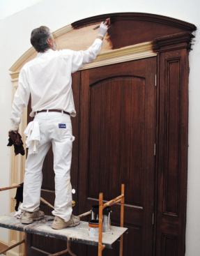

I apply stains in a single coat using a china bristle brush, then wipe off the surface with a rag to even out the color. If hidden glue or water spots emerge while I'm staining, I try to sand out the spot immediately with 150- or 180-grit sandpaper, then blend the spot back in with more stain, rather than trying to fix the problem later, after the stain has dried.

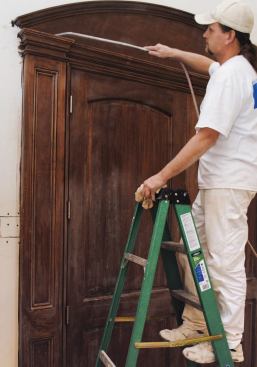

Sanding sealer partially fills the grain, helps create a smoother final finish, and improves moisture resistance. There are a number of sealers on the market from various manufacturers, but I prefer to use Sher-Wood Fast Dry vinyl sealer because I know that it's compatible with BAC stains and the top coats I use. In most cases, I spray on two coats using a Graco 595 airless spray rig with a #411 tip, which has a 0.011-inch opening and an 8-inch spray pattern at 12 inches.
I allow at least 30 minutes drying time between coats and always let the second coat of sanding sealer dry overnight. Then I sand everything thoroughly with fine-grit 3M sanding sponges (866/279-1288, 3m.com) to prepare the trim for the top coat. To remove the sanding dust from cracks and grooves, I blow the trim off with compressed air before wiping the surface down with a rag dampened with mineral spirits.

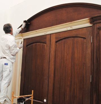

I sprayed the doors and trim on this job with pre-catalyzed Sherwin-Williams CAB (cellulose acetate butyrate) acrylic lacquer with a medium rubbed gloss, using the same spray setup I used to apply the sanding sealer but with a new #411 tip to improve atomization. Though this product is intended for shop use, I've had good luck spraying it on site (VOC regulations limit availability in some areas). It's a non-yellowing finish that can be tinted to even out the color or make the results redder, browner, or darker. Sherwin-Williams recommends the use of specific colorants, but I've found that I can simply add a few ounces of the same oil-based stain used on the trim to each 5-gallon container of lacquer. I mix lacquer thinner with the stain before adding it to the lacquer to prevent the stain from coagulating and developing a cottage cheese-like consistency (though adding too much stain and lacquer thinner can dull the finish or make it look muddy). On this project, I didn't have to stain the top coat - but if I had, I would have tinted only the initial coats and built up to the color with multiple passes before spraying a clear finish on the final coat.
Lacquer retarder can be added in very humid conditions to slow down the curing process and avoid trapping moisture in the finish. If flushing, rainbows, and flat or shiny spots develop after the first coat, I mix lacquer retarder with lacquer thinner and spray it onto the finish before applying any additional coats. This seems to open up the finish enough to get rid of excess moisture without damaging it.
I typically spray three or four coats of lacquer, allowing 30 to 40 minutes drying time between coats. After each coat except the last, I go over the trim lightly with a fine sanding block to knock down any light fuzz or smooth out splotches in the finish. Since this finish is for interiors only, I finished the exterior door surfaces with several coats of brushed-on McCloskey Man O'War spar marine varnish (877/825-7727, valsparglobal.com).
