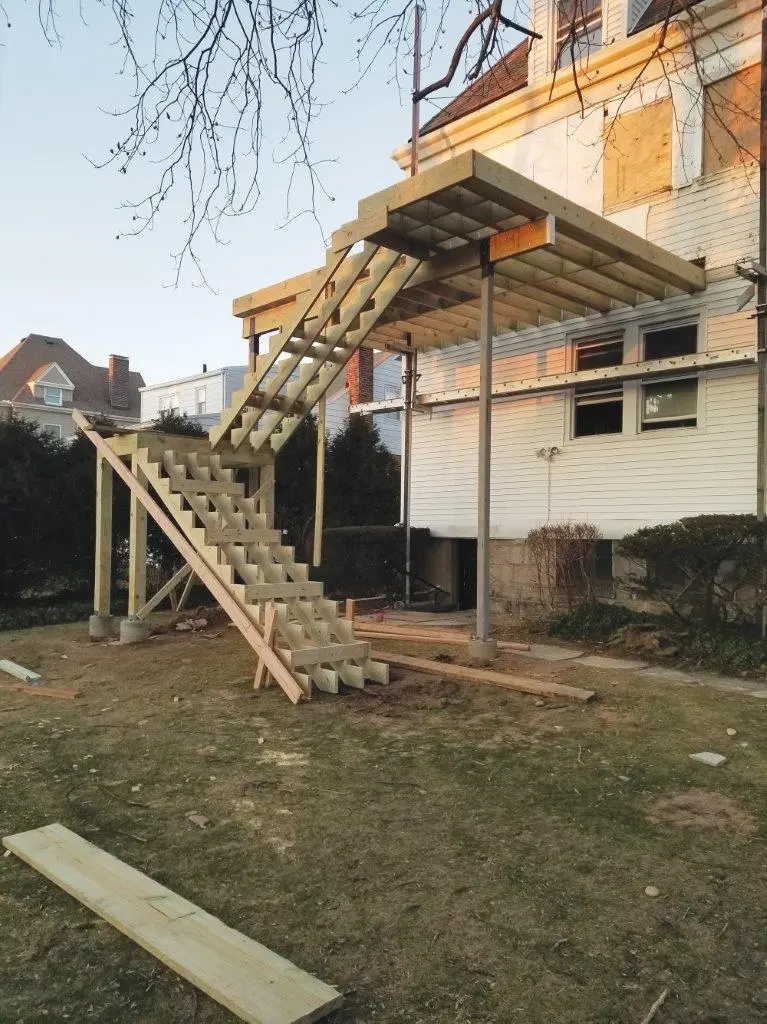

With the footings poured and the columns bolted into place, we wrestled the heavy girder—which consisted of two 18-foot-long 2x12s sandwiched around a 3/4-inch-thick steel flitch plate—into place on top of the columns and framed the upper deck. Then I started working on the staircase layout.
The plans called for two stairs separated by a midpoint landing. Typically, I try to start with the landing platform location and work my way up or down, adjusting the elevation as needed. For this project, there wasn’t a question of where the platform would land, because of the layout work that I’d done in SketchUp earlier.

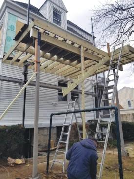

The second-story deck is supported by a double 2×12 steel-reinforced beam that bears on 4×4 steel columns.

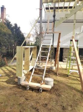

After cutting the first stringer, the author used it to determine the elevation of the midpoint landing, which was framed on the ground.
The midpoint landing was then lifted into position and placed on temporary supports.

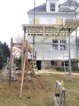

The author used the outside stringer to fine-tune the orientation of the landing.

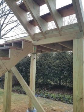

That being said, I’m still an analog man living in a digital world, and I opted to hang the first stringer temporarily to double-check my measurements before framing the midpoint landing. After verifying the location with a quick measurement from the bottom step to a plumb bob hanging from the upper deck, I made a 1-1/2-inch-deep notch in the bottom of the stringer where it would meet the platform. This ensured that the height of the first step would be correct, and it also made for a solid connection between the stringer and the landing. The notch in the stringers also meant that I had to make the landing platform 1-1/2 inches wider, which pushed the bottom of the staircase out slightly farther.
With the first inside stringer supported, I could install the landing platform, which I framed on the ground as a 2×10 pressure-treated (PT) box with a single joist and some supports to keep it square while I worked (installing all the joists at that point would have made the platform heavy and hard to lift up into position). Then, with the platform lifted more or less in place and temporarily supported, I started to install the second outside stringer. At this point, it was easy to tell if the platform needed to be rotated slightly to move it into the right position. Once the second stringer fit tightly against the framing, I knew the platform was squared up with the landing above.

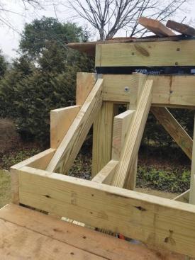

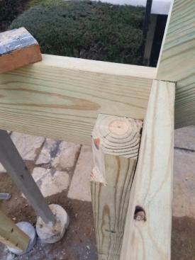

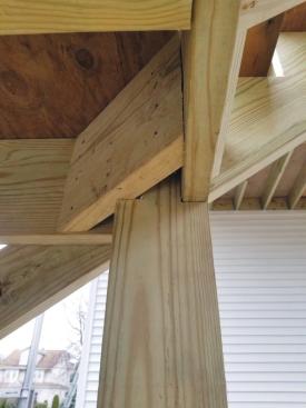

I hung a plumb bob from the deck’s rim joist to help make sure the upper deck and midpoint landing were in final alignment. Then I cut all my 6×6 PT posts to length, adding a 1-1/2-inch-by-5-inch notch to two sides at the top to give the platform a solid bearing all the way to the foundation. Before installing the posts, I also cut a 45-degree notch on the back of each one at the top to accommodate diagonal blocking that would be installed later.
Blocking and Bracing

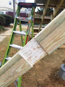

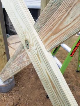

To help stabilize the landing, I installed diagonal bracing from the footing all the way up to the bottom of the platform. I cut the braces from 2×6 PT lumber, and at the intersecting points of both boards, cut a half-lap joint. I added a little exterior-grade wood glue to the joint and clamped the boards together, allowing the assembly to set overnight before installing it. Though not specified on our plans or required by the building department, the bracing completely eliminates any side-to-side wobble in the landing platform.
The author reinforced the landing platform with blocking. First, he notched the back of the 6×6 support posts at the top, as shown.
Then he installed diagonal blocking that strengthens the connection between the posts and joists.
He also reinforced the landing platform with cross-bracing, fitting together a pair of PT 2x6s with a glued half-lap joint.
After adding mechanical fasteners to the assembly, he fastened it to the inside support posts with structural screws.

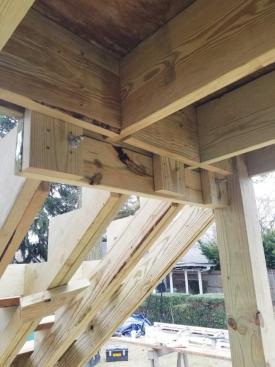

The hanger board detail is something I picked up from several places, and I’ve added my own touches to it over the years. I know many builders like to hang their stringers from PT plywood fastened to the rim joist, but I prefer to hang a 2×6 underneath the 2×10 rim joist, connecting the two together with vertical 2-by blocking to provide solid bearing for my plumb-cut stringers.
The stair stringers were hung from a 2×6 connected to the rim joist with vertical blocking and a combination of structural screws and ThruLok bolts.
After fastening the stringers to the hanger and rim with structural screws, I installed 2×8 blocking between all of the stringers where they met the hanger board. When all the pieces were in place, I fastened the assembly together using nails, ThruLok bolts, and structural screws through the entire stack of blocks above and below the hanger board. I reinforced the stringer-to-hanger connection with steel angles, then added self-adhering flashing tape at the top of the meeting points to keep water out of the assembly.

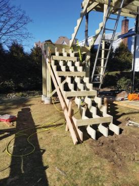

To make the stringers more rigid, the author reinforced them with sistered 2x6s.
Blocking was also used to reinforced the connection between the upper stringers and the landing platform.

The original plans for this deck called for the installation of three stringers with equal spacing, creating a span of almost 18 inches between stringers for the treads. Adding an additional stringer allowed us to keep the on-center spacing for the treads to under 12 inches.
Anytime you have a long set of stringers, the span’s center can (and will) tend to get a bit bouncy. By the time you cut your steps out of the 2×12, you have only about 5-1/2 inches of material left in the throat of the stringer (the minimum throat required by code in our area is 5 inches). Increasing the number of stringers helps to take out some of the bounce, but so does fastening a 2×6 to the throat of each stringer (in our area, we refer to this as scabbing). We cut the scabs at the same time we cut the stringers, then sister them together after stringer installation using structural screws and galvanized framing nails.

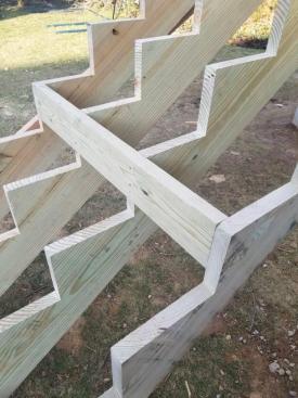

Another step we take to reinforce stairs is to connect the stringers together with continuous blocking. We do this by cutting 1-1/2-inch-by-5-1/2-inch notches into selected risers of the center two stringers, then nailing 2×6 blocking to the notches and the outer stringers. This helps keep the tops of the stringer treads aligned, is easier to install than individual blocking between stringers, and makes for a solid support system. I usually install this blocking every three or four steps (or every quarter of the way up a stair span), but more or less can be added depending on site conditions.

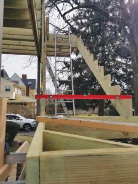

Another step the author took to strengthen the stringers and make them straighter was to notch the middle stringers and install 2×6 blocking.
Located every few steps, the stringer blocking keeps the tops of the treads aligned and ties the assembly together into a solid unit.
