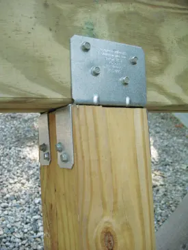

Metal connectors are good at managing load paths and post displacement, but I haven't found any that are particularly effective at handling beam rotation. For that, I want a wood bridge between the beam and the post. Beam rotation isn't a problem with every post-to-beam connection, though, so I plan accordingly. The specific detail I use depends on the size of the post, the position of the beam, and whether the installation is for a new deck or a retrofit. In addition, I need to be sure that the posts have adequate diagonal bracing to resist deck racking.

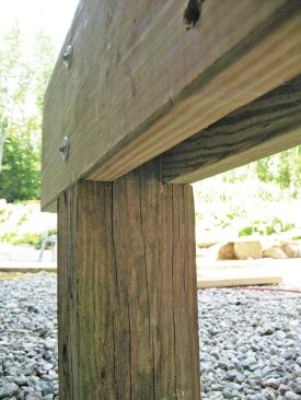

Notched posts. A common method of addressing beam rotation is to notch a 6x6 post to accept a two-ply beam while leaving a 2 1/2-inch-thick attachment leg to bolt the beam to. Once the beam is fastened to the post with a pair of 1/2-inch bolts, the assembly will prevent beam rotation, and the integral post leg will also provide uplift-load-path continuity. One advantage of this configuration is that it doesn't require any additional metal connectors; another is that it's presented as a code-compliant connection in the American Wood Council's DCA6 Prescriptive Residential Wood Deck Construction Guide (awc.org).

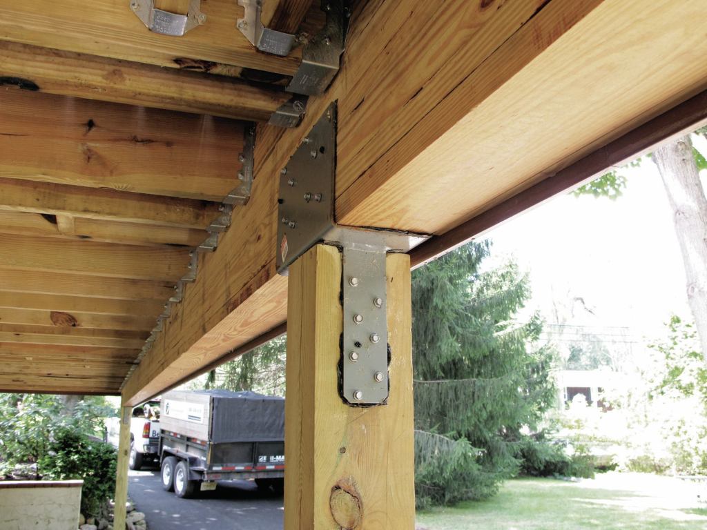

Post-to-Beam Hardware

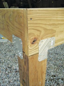

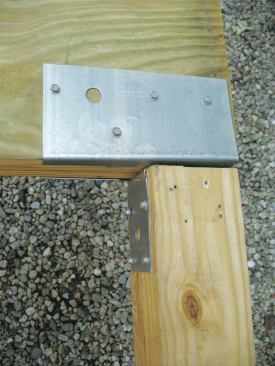

These days, there are almost too many hardware options for connecting posts and beams together. Some metal connectors are designed for new construction and must be positioned on the post before a beam is placed (or vice versa). There are also connectors that can be applied after the beam is placed atop the posts, making them well-suited for retrofits as well as for new construction. Some connectors fasten posts along the middle of a beam, while others are designed for the end post (slideshow).
When grabbing hardware out of a bin at your local lumberyard, remember that metal connectors are sized for different types of beam stock. Two connectors may look identical, but one model may be designed for solid-sawn beams and measure 31/2 inches or 51/2 inches between flanges, while another model is designed for built-up beams and measures 3 inches or 4 1/2 inches between flanges. Smashing mismatched hardware into submission is not an option, since hardware manufacturers won't support deformed hardware installations.

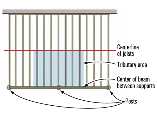

Some deck builders like to bolt 2-bys to either side of the posts, though this detail generally won't comply with building codes without an engineer's stamped drawing. But a few options do meet code if you like the idea of side-mounted beam plies. One approach is to notch a 6x6 post on both sides to provide shelves for the 2-bys to rest on. A second is to install jack studs beneath the 2-by beam plies. Screwed, bolted, or even nailed to the primary 4x4, 4x6, or 6x6 post, each jack should extend from the bottom of the beam ply all the way down to the footing in a single piece, one on each side of the post.

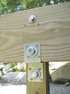

You can also use metal hardware to secure the connection, though if you choose this option, you'll have to do some calculating to determine the post spacing based on the deck load. Since the hardware is rated for vertical loads, you have to determine the tributary loads (see Tributary Loads, sidebar) the deck will impose on each connector, to ensure the connectors aren't overloaded.
The load capacity of this hardware depends on the brand, size, and diameter of the nails, screws, or bolts used to make the connection. Once you've determined the maximum load per connection based on your chosen fastening method, you then space footings and posts according to the maximum tributary load at each beam-post connection. And even though the connectors can be installed with nails alone, I recommend using bolts in addition for a more robust connection (see Bolt Alternative, sidebar).

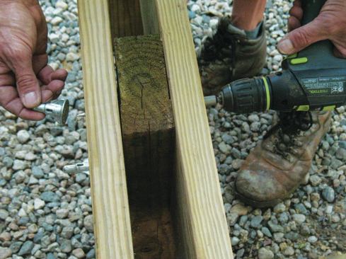

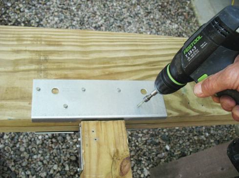

Instead of using nails to install metal hardware, consider using structural connector screws instead. I prefer structural screws for almost every piece of deck hardware, including joist hangers, post-to-footing and post-to-beam connectors, and wind-uplift ties.
Not only do screws often increase allowable loads, but they make it much easier to remove and reinstall hardware (which is next to impossible with nails). They install just as quickly as pneumatically-driven nails and with far more control. Compared with pounding in nails by hand? There's no contest.
Connector screws come in 1 1/2-inch and 2 1/2-inch lengths (the longer screws are used for the diagonal "shear" holes on joist hangers). Both USP and Simpson offer connector screws for many of their hardware pieces, though I haven't found stainless steel connector screws for stainless hardware. My local lumberyard stocks Simpson connector screws (800.999.5099, strongtie.com); USP screws (800.328.5934 uspconnectors.com) seem to be a little harder to find in my area. The screws are rated for use only on same-brand hardware, so technically, you can't mix and match.
