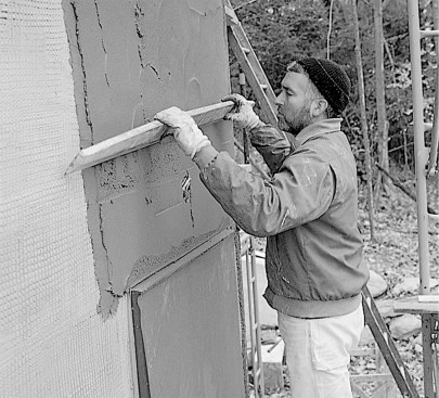

A 1/4- to 3/8-in.-thick brown coat is applied over the scratch coat and "rodded" with a straightedge.

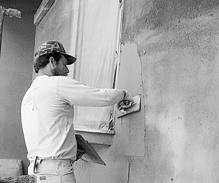

A 1/8-in.-thick finish coat is applied with a trowel.
