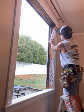

Good windows installed poorly become bad windows in a hurry. Silva’s process starts with measuring the opening, not guessing through the glass. He schedules a separate visit, pulls interior stops where needed, measures at multiple points, and orders exact sizes. That discipline has paid off. “I’ve done about 2,000 replacement windows … [with] maybe two” mis-measures, he says. On install day, he and his crew take the time to set, shim, and square so the sash operates smoothly before any foam or sealant goes in. “Replacements are easy to do, but so many people just slam them in place,” he says. “They don’t adjust them … and a year or two later, they’re not working properly.”

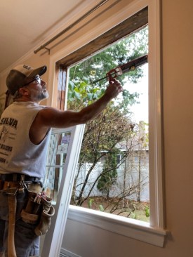

A continuous bead of sealant at the perimeter readies the opening for the new unit.

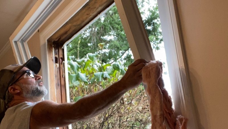

Silva takes a similar approach. His estimates spell out the sequence—remove stops, remove pockets/weights, air-seal cavities, set and shim, foam and caulk—so bids can be compared apples-to-apples. When hidden rot appears, he pauses, prices the change, and gets sign-off immediately. The worst time to discover scope creep is at the end.
