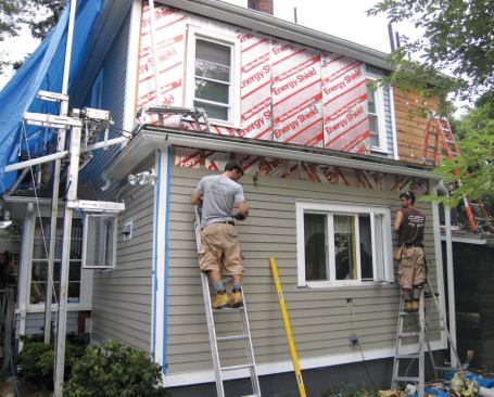

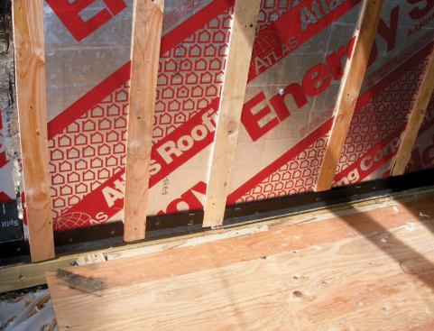

That’s when we began to talk about improving the home’s energy performance, too. I suggested that we add rigid foam underneath the siding to help eliminate drafts and reduce noise from a nearby highway. To seal the deal, I guaranteed that the new foam would pay for itself in just a few years by lowering his heating bills.

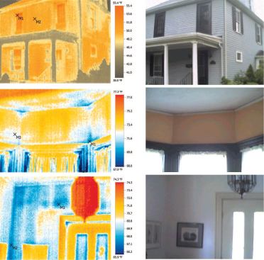

To find out just how much insulation was in the walls, I scheduled an infrared (IR) camera inspection with the insulation contractor at the beginning of the job. I knew that the attic had only 6 to 8 inches of cellulose and blown fiberglass insulation, but I was surprised when the IR images showed that there was virtually no wall insulation in most of the house. Once I had explained the test results to the homeowner and gone over the benefits of cellulose wall insulation, convincing him to add it to the scope of work was easy.

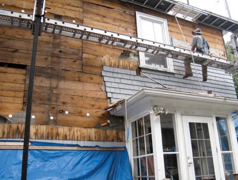

Since it was an unusually rainy summer, we focused on one side of the house at a time when we set up our staging and began stripping shingles. To stay dry when it rained, we hung tarps off the gutters, draped them over the tops of our Alum-a-Pole staging, and staked them out in the yard behind us.
In some areas – such as below windows or where there was blocking – we discovered voids in the cellulose as we stripped off the shingles. In those places we pulled off the exterior 1×12 board sheathing and insulated with fiberglass batts. This was faster and more cost-effective than calling back the insulation sub, especially since we would be installing another blanket of rigid foam anyway.

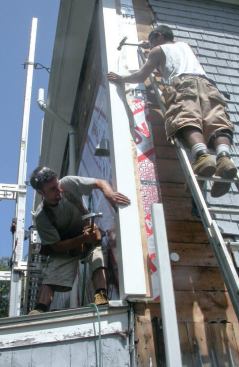

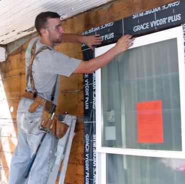

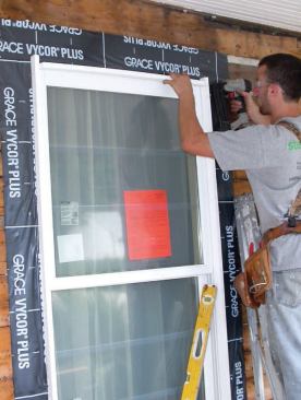

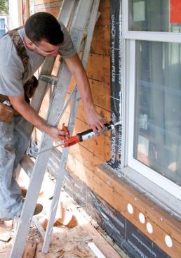

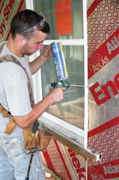

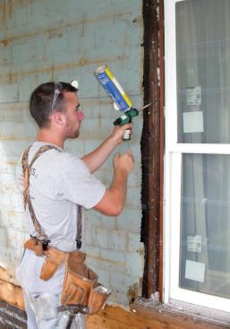

We filled small voids around the windows – like unneeded sash weight pockets – with spray foam. Then we sealed the window frames to the 1×12 sheathing with 4-inch-wide Grace Vycor window flashing (866/333- 3726, www.na.graceconstruction.com), taping the bottoms and legs first. When we taped across the tops of any windows that were exposed to weather, we used wider 6-inch Vycor and left a 2-inch flap (with the release paper backing still attached) hanging down over the head jamb. Later, when we fastened the jamb extensions to the frames, we folded these flaps back, peeled off the remaining release paper, and attached the flashing to the extension. The flaps act as sheathing-level drip caps that keep water out of the joints between the jamb extensions and head jambs.

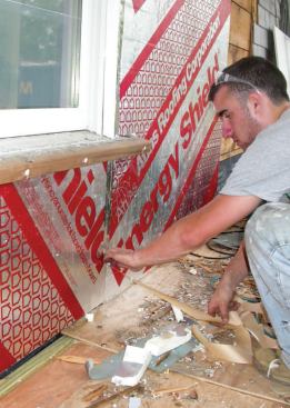

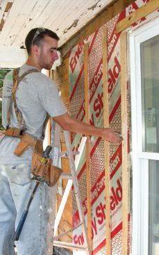

We ripped jamb extensions from Azek, a low-maintenance cellular PVC product (877/275-2935, www.azek.com), making them 1 3/8 inches wide to accommodate the 1-inch-thick rigid foam and 3/8-inch-thick plywood rainscreen battens that would be added to the wall. We fastened the extensions to the jambs with 2 1/2-inch trim nails and welded their corners together with PVC glue.
The sill extensions were ripped from 2×4 cedar. We beveled them to match the angle of the existing sills and made a shallow relief cut on the underside to serve as a drip edge. Then, after applying exterior carpenter’s glue, we fastened them to the sills with 3-inch-long screws driven through predrilled countersunk holes. We filled the holes with Abatron two-part epoxy putty (800/445-1754, www.abatron.com).
