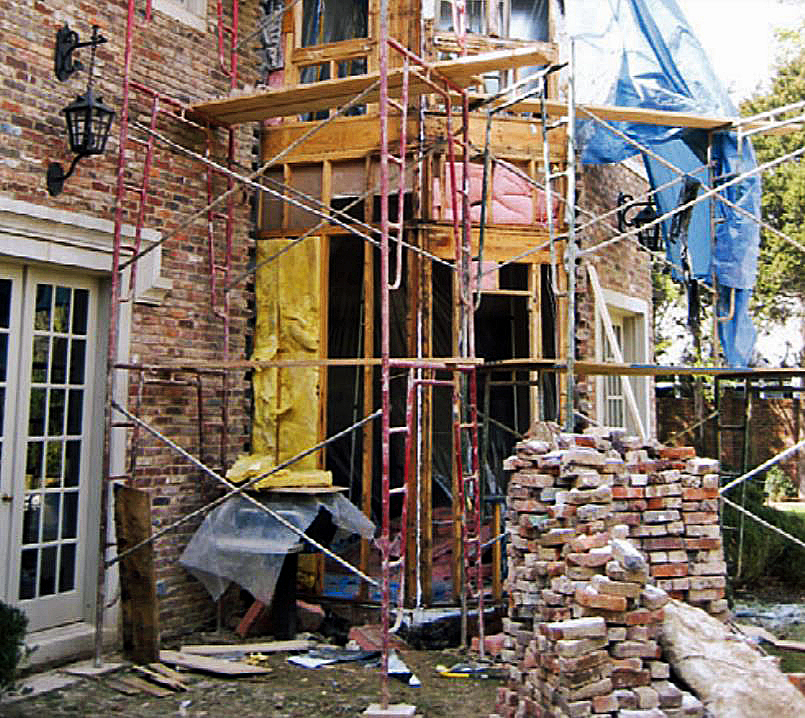

In this article, I’ll focus on standard residential brick veneer — that is, nonstructural brick installed as a cladding over wood framing — and share examples of some of the failures I’ve inspected. Sadly, I see the same mistakes made again and again — mistakes that often result in very expensive callbacks.

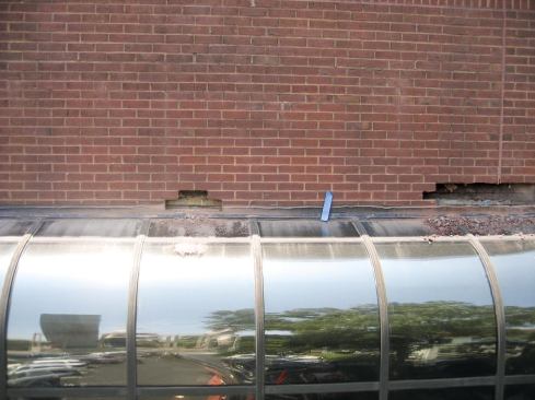

Take the house whose repairs we cover in the slideshows. The owners reported recurring leaks and damage to pricey custom finishes inside. By the time I was called in, they were understandably upset at the many failed attempts to fix the problem. Typically in a case like this, the “repair” consists of applying tubes of caulk or mastic around windows and flashings — inevitably a waste of time. As you can see from the photo, getting to the root of this house’s problem was a little more involved than that.
So how can a material so durable go so wrong? Simple: It doesn’t. As with any building material, successful installation depends on workmanship and details — rarely does the brick itself fail. Laying up a flat wall with straight, even courses and raking the mortar joints is the easy part; the challenge is making sure that the brick is supported properly, that it’s securely tied to the structural wall sheathing, and that adequate measures have been taken to ensure that moisture that gets behind the brick can exit to the outside.

The main cause of moisture problems in the brick homes I investigate is the lack of proper through-wall flashings (see slideshow below). For example, one common source of leaks is the counterflashing installed where a sloped shingle roof abuts a brick wall. The metal is usually 4 or 5 inches high, follows the shingles in a straight line parallel with the roof, and may have an occasional fastener through its face into a mortar joint.
Typically, the suspect flashing is turned in about 1/4 inch to 1/2 inch along the top and simply let into a kerf cut in the mortar or brick with a masonry blade. But the biggest warning signs are the nails and the copious amounts of caulk along the top edge. Even when I find the metal installed in stair-step fashion down a brick wall, it’s still most likely a saw-cut job, where the counterflashing was installed after the brick had been laid.
Where to Flash
The building codes and Brick Industry Association ( bia.org) standards call for through-wall flashings at several critical points: where a roof abuts a brick wall, within one course of brick above and below doors and windows, and just above grade below ground-floor level.

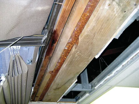

Rake sidewalls. Wherever a gable roof — on a garage, for example — meets a higher brick wall, you’d better pay attention. On a lot of the new houses I inspect, the sidewall brick lands right on the roof sheathing, with maybe a doubled rafter underneath. Worse, I actually see houses where the brick comes right down on top of the step flashing — those will be fun jobs to reroof.
Without getting into the issue of structural support, I want to point out that unless there’s a through-wall flashing abov the garage roof surface, any water that gets behind the brick will be headed right down into the framing and the interior finishes.
Unfortunately, the kerf method appears to have totally replaced use of proper through-wall flashings at roof-to-wall intersections. Admittedly, doing the job correctly is a detailed process that requires coordination between the roofer and the mason (see slideshow). But it’s the only way to guarantee that water entering the brick from above will not cascade down into the living space below.

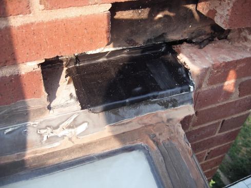

Window and door heads. There should be through-wall flashings below the first course of brick along the top of windows and doors. The steel angle is for structural support only; it should not be used for flashing. For example, some contractors will lap the felt or housewrap over the top leg and rely on the angle to keep water out. More often, though, there’s no flashing anyway, and the steel is installed on top of the housewrap.

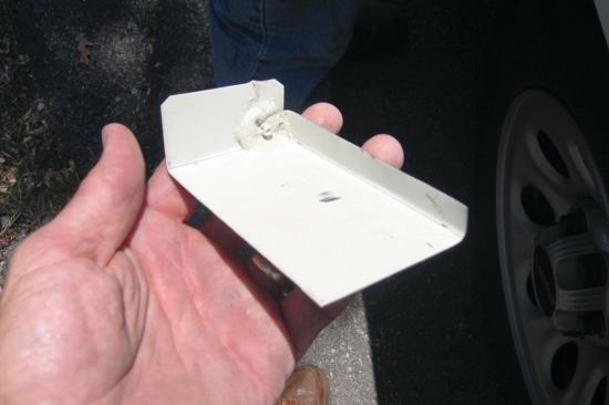

Window sills. Through-wall flashing should also be placed under the sloped course of brick (typically rowlock) immediately below the window. This is meant to catch any water that makes it into the wall cavity through or around the window. Sills should always be sloped at least 15 degrees, per BIA standards.

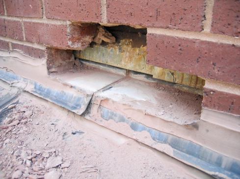

Above grade. Too often, the bottom courses of brick are simply buried in the soil. There should be a through-wall flashing under the last course of brick above grade; this course must also be below the bottom of the first-floor framing. Flashing at this location serves two purposes: It prevents ground moisture from wicking up into the wall, and it catches any water coming from the cavity above and sends it outside.

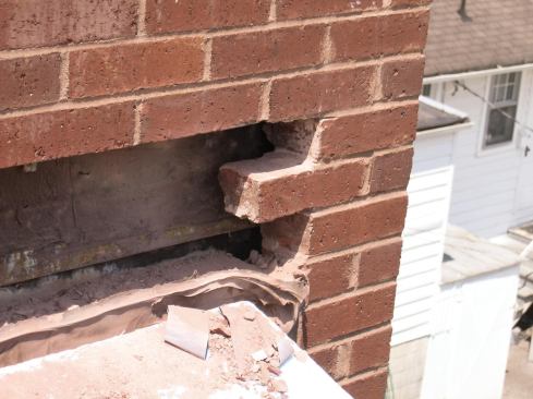

Through-wall flashing should extend to the outer face of the brick. Anything short of that is that much less effective at getting the water out. And the back upper leg must be placed under the layers of building paper that protect the sheathing.

If wall cavities were created in a perfect world, they would be just that — cavities. The mortar, and any water it holds, would stay completely away from the felt or housewrap that guards the wall sheathing. But since masons are usually pressed to do their jobs as quickly as possible, excess mortar on the back of the brick will naturally collect along the bottom of this cavity. As a precaution, always make sure that the back leg of the through-wall flashing at the base of the wall reaches above the likely level of the mortar droppings — 8 inches is good for a single-story house, more for additional stories.

When inspecting leaky brick homes, I often note that there are no weep holes, or that they are in odd locations. Contractors, when pressed on the issue, may insist that there are indeed through-wall flashings behind the brick, though at this point I have my doubts. Sometimes I’ll find head joints that have been drilled out after the fact to provide weeps. In that case, even if there were flashings in the wall, there’s a good chance that they would now have holes.

For through-wall flashings to work their best, there should be weep holes to allow the water out. The Brick Industry Association — my preferred source for details on the correct way to install brick veneer — recommends leaving an open head joint every 24 inches. The IRC allows for weep holes that are as small as 3/16-inch in diameter, every 33 inches immediately above the flashing.
On the other hand, even if there are no weep holes but there is a proper through-wall flashing that terminates on the face of the wall, the collected water will eventually evaporate or get out through the tiny cracks in the mortar before it can damage the framing.
