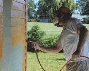

Spray Technique
On home-improvement shows, the act of spraying tends to be oversimplified. Spraying is both a technique and an art; you must take into account the different surfaces, paint types, and items to be sprayed around.
In almost all cases, the gun should be held straight up and down, parallel to and 12 inches away from the surface. Move your whole body along the surface, not just your wrist and gun; they should stay in the same fixed attitude while spraying.
When spraying, activate the trigger before moving over the receiving surface, then continue moving beyond it before releasing the trigger. Application speed must be consistent; moving too fast or pulling the gun away leaves too little paint on the surface; moving too slow or angling the attack so that the gun is not parallel to the wall can lead to overapplication and drips. This is the art of spraying; getting the right results is a matter of knowledgeably gauging various factors — speed, material, surface.
We typically spray big areas first, then move to the smaller parts, using different tips to cut into corners and around windows and protrusions. We always make generous use of paint shields and drop cloths.
