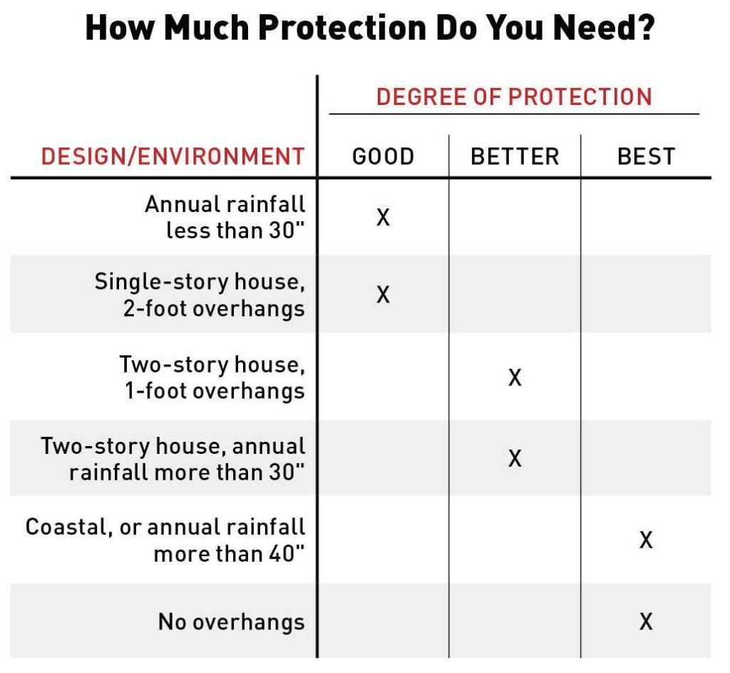

Dr. Joseph Lstiburek, the founding principal of Building Science Corporation, has said, “Rain is the single most important factor to control in order to construct a durable building.” And the architectural design of a home can influence how much rainwater lands on the walls of a building.
Roof overhangs. The absence of roof overhangs in many new houses allows more water to hit the walls. Here’s an analogy: Roof overhangs are like an umbrella in a rainstorm. If you don’t have an umbrella, you better make sure you’re wearing a high-quality raincoat, or you’re going to get wet. Think of a good WRB system as being like a raincoat for the house.
Roof pitch. Shallow-pitch or flat roofs also contribute to the amount of water hitting a wall during rainy, windy conditions. A steeper roof, on the other hand, can act like an airfoil, pulling rain up over the roof and pushing it away from the walls.
Wall height. The system that should be used is dependent on the location and design of the house you’re building. It’s a matter of the walls’ exposure to water infiltration—more exposure will require a higher level of protection. For instance, a single-story house with a pitched roof and broad overhangs located in an inland location that doesn’t receive much annual rainfall won’t need nearly as much protection as a two-story building (which will have higher, more exposed walls) with a flat roof located on a windy, rainy seacoast (see chart, below).

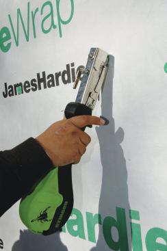

Capped fasteners. Some housewrap manufacturers recommend, or require, the use of a cap stapler to install their products, for the extra water resistance and holding power staples provide. We use a Stinger CH38 hand cap stapler.

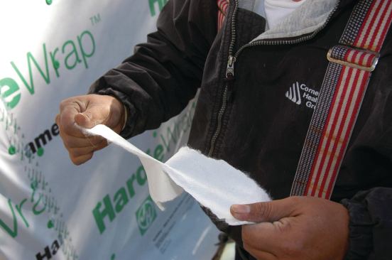

In general, avoid any housewrap that’s not durable. My crews are diligent and careful, but some wraps can’t stand up to much, if any, abuse. If a product tears easily, steer clear of it.
I also avoid perforated, pin-pricked plastic housewraps sold by the big box stores. If you can see though a sheet of housewrap when you hold it up to the light, it’s a good indication that it isn’t going to keep out water. To see the fallibility of the pin-pricked wraps, you can easily duplicate a quick demonstration that I show on my YouTube channel. Place a 12×12-inch square of one of the good housewraps mentioned below and a similar-size square of pin-pricked housewrap on top of a paper towel. Pour a few tablespoons of water on each housewrap square, then set a coffee mug on each water puddle. Wait five minutes, then lift up the mug and the housewrap and see which paper towel is soaking wet.
You might want to try this simple test using any housewrap you’re considering. Then decide which product you want on the next house you build.

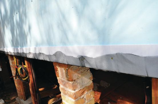

I like to use a housewrap that has a textured surface as the first defense for draining out moisture that infiltrates behind wall claddings. The small gap it creates between the back surface of the cladding and the sheathing allows water to drain away to the ground. Manufacturers use a variety of patterns and technologies to hold the siding away from the sheathing when it’s installed.
Dupont, the parent company of Tyvek, manufactures a family of small-gap housewraps. Two that I use are Tyvek Drainwrap and Commercial Wrap D. The main differences between them are that Commercial Wrap D is slightly tougher, and it has a longer UV-exposure time, so it will last longer if it’s going to be a while before you install siding. Both have a slight, almost crinkled corrugation, which when installed properly creates vertical channels for water to run out. Regardless of how tightly the siding is attached to the sheathing, Drainwrap and Commercial Wrap D create enough of a space between the back of the siding and the wall for water to drain away.

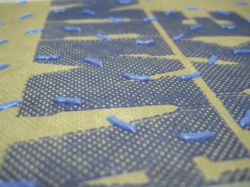

Benjamin Obdyke’s Hydrogap housewrap has 1-mm–thick blue plastic oblong dots bonded to its surface. The thickness of the dots holds cladding away from the wall and creates a space for water to drain away. One of the things I like about Hydrogap is that it can be installed in any direction, even rolled out vertically, without its draining abilities being affected.
All the housewrap manufacturers sell proprietary tapes and flashing materials to use with their products. I stick with the manufacturers’ branded tapes that go with their housewraps and prefer ones with butyl adhesives. Tyvek’s StraightFlash and FlexWrap are among the best in the market.
Not all brands of housewrap are available everywhere in the U.S. If you can’t find one of the brands I prefer, look for a wrap with some kind of built-in air gap. Once you find one, give it the tear test, and if you can get a sample, try the water test, too. Some housewraps can even be bought online. Benjamin Obdyke, for instance, will sell direct from its store website, and it offers free shipping.

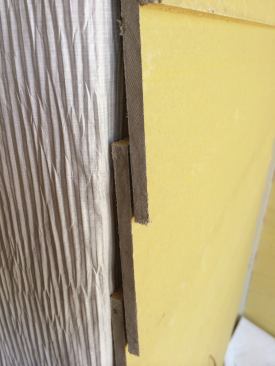

There are lots of different materials you can use to form a rainscreen, including 1×3 solid wood strapping, or ripped strips of HardiePlank for walls covered with that product.

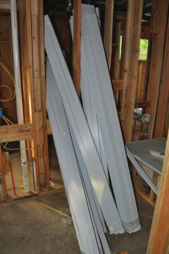

My favorite rainscreen material is Coroplast, a two-layer recycled-plastic sheet product that’s sold in 4×8-foot sheets and used mainly by sign makers and print shops. The outer layers of the product are held apart by parallel flutes that give the material thickness and rigidity. The flutes are continuous along the product’s 8-foot length. Coroplast is available in various thicknesses; for rainscreens, I use 3/8-inch-thick Coroplast.
The material is easy to rip into strips on a table saw, though I buy it from my sign supplier already cut into 2-inch strips.
For the top and bottom of a wall, we use other, 3-inch-wide strips with the flutes running vertically, which allows convective ventilation behind the siding at the top of the wall and water drainage at the bottom of the wall. Before installing the top and bottom strips, we staple on an 8-inch-wide strip of insect screening, then fold it back over the Coroplast to keep out bugs.

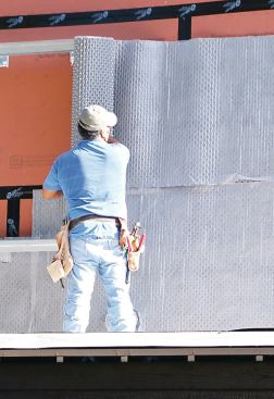

For the ultimate protection on walls, there is another category of WRB systems that includes fluid-applied membranes and peel-and-stick membranes. Unlike some other WRBs, these products have the added benefit of air-sealing a wall, as well as protecting it from moisture. Both should be used in conjunction with an installed rainscreen.

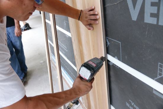

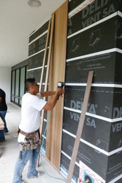

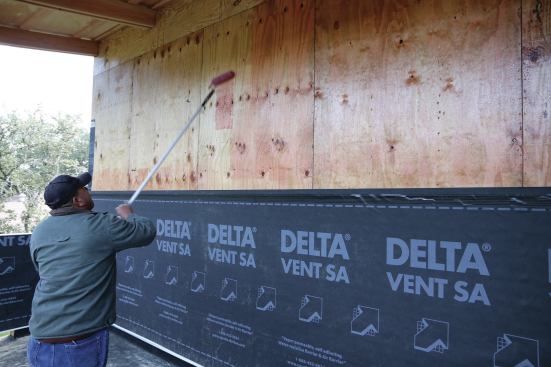

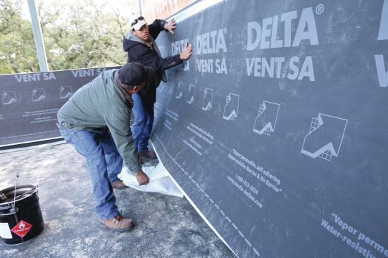

I’ve been very impressed with a German peel-and-stick product, Delta-Vent SA that we recently used on a house. There is a fair amount of labor involved in the installation: The sheathing is first covered with a paint-on primer. Then the 3-foot-wide material is unrolled on the wall; once it’s in position, you pull off the backing paper and smooth it into place. A double-stick layer at the edges creates an airtight seal at all the overlapping seams. There are also proprietary tapes for flashing windows and wall openings.

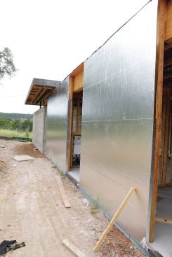

Another peel-and-stick WRB product we’ve used is Aluma Flash—a laminated rubberized-asphalt product. The rubberized-asphalt layer is 40 mils thick and laminated to two layers of polyethylene film, with a top protective layer of aluminum. The aluminum outer layer helps this product withstand UV rays almost indefinitely. It’s applied similarly to Delta-Vent SA.

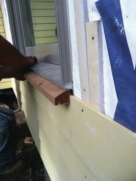

We have also used fluid-applied flashing and seam-sealing products from Tyvek. They work extremely well for tricky inset window installations. You squirt them on from a caulking gun, then use a trowel or brush to spread the materials, which have the consistency of thick paint. Once cured, they form a rubbery, airtight and watertight bond.

Fluid-applied WRBs are elastomeric products that can be sprayed, rolled, and even brushed on a wall. Depending on the product, some joint and seam filling or priming may be needed first. The cured products form an elastic, airtight, vapor-permeable, and waterproof covering that will stretch and contract a bit as a building moves.
Residential-grade fluid-applied products are thinner, however, than commercial-grade products, which range in thickness from 30 to 75 mils. At that thickness, the material is almost squishy when cured and provides something of a gasketing effect around fasteners for brick ties and the like. My current preference at this point would be to specify one of the commercial products.

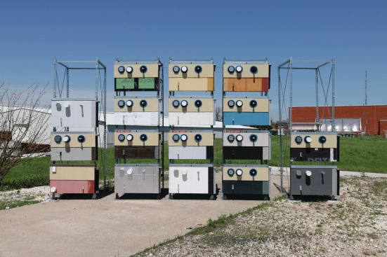

I recently visited the University of Texas at Austin Construction Durability Lab to see its ongoing testing of WRBs. Mocked-up wall panels were covered in a variety of WRBs, as per manufacturers’ specifications, then left out in the weather, where they’ve been for almost two years now.
As would be expected, the tar-paper-covered panel has not fared well, whereas the thicker, commercial-grade fluid-applied WRBs have performed the best. The thinner, residential-grade fluid-applied WRBs are no better than elastomeric paint, and do not perform very well. I’ve written about the tests on my blog at mattrisinger.com, and I’ll continue to post about them as more test results come in.
