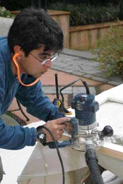

The fin is designed to fit into a kerf, so the next thing we did was use a router and three-wing cutter to cut a slot on each edge of the sash about 3/8 inch in from the outside face. It's important to use the right-size bit. If the kerf is too narrow, the fin won't go in; if it's too wide, the weatherstrip won't stay in place. Our supplier made sure we had the correct 2-mm (.078-inch) bit to make the cut.
The slots for the weatherstripping were cut along the edge of the sash just in from the outside face.
