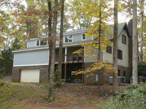

In 2012, long-term customers asked me if I could install a tile floor on their wood-framed porch. I’ve installed tile over wood-framed floors in interior wet locations such as bathroom and shower floors many times using Schluter’s Kerdi waterproofing membrane. Schluter also makes a similar membrane— called Ditra—that can be used in exterior tile applications over wood substrates. For decks built over occupied living space, there’s a Kerdi specification (called D-EXT-OS-13) that requires a roofing membrane installed on a plywood deck, followed by a drainage mat and a 1 ½-inch-thick reinforced mortar bed. A Schluter-Ditra membrane is then installed over the hardened mortar bed prior to actual tile installation. This approach is well-nigh bullet-proof, but would obviously be expensive to install.
At the time of the project four years ago, Schluter also offered a less-expensive detail for building over unoccupied spaces (called D-EXT-W-13), which merely called for the installation of cement backerboard over the plywood, with the Schluter-Ditra membrane installed on top of the backerboard. Since the porch that I would be working on was over unoccupied space and was in a very sheltered location, we decided to go with this less-expensive design.
In this application, the Ditra membrane serves several functions. In addition to being a waterproofing membrane, the polyethylene material acts as an "uncoupling" layer that allows for the differential movement that occurs between the plywood layer and the more-rigid masonry layer. And unlike Kerdi, the membrane has dovetail-shaped recesses that provide a mechanical bond between the thinset and the membrane and that enhance the support of the tile layer.
Prepping the Floor System
The porch floor system, which was about 10 feet above a concrete patio, had been framed with treated lumber as part of a major three-story addition. With a temporary plywood deck, the porch had served for several years as a makeshift shop and staging area for finishing the rest of the addition. Built within a 10-foot-by-22-foot inset, the porch was protected by walls on three sides and covered by a roof, the eaves of which extended about one foot beyond the single open side of the deck. Set in this sheltered location, very little rain fell on the deck in most storms.

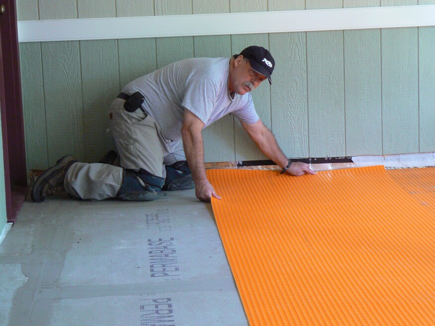

Schluter-Ditra Membrane

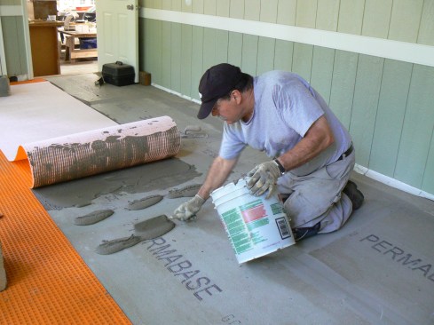

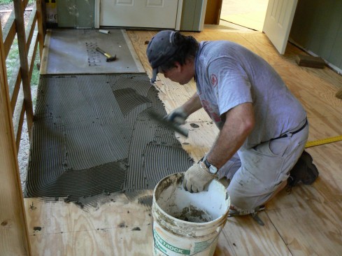

To adhere the Ditra membrane to the backerboard, I used unmodified thinset mortar applied with a ¼-inch square-notched trowel. The membrane is 1 meter (39 inches) wide and, to avoid unnecessary seams, I installed it in strips that were the full length of the porch (21 feet). This made for the installation of a fairly large sheet of membrane.
A Schluter-Ditra membrane was used to waterproof and prep the floor for tile. Before installing it, the author cut and dry-fit all the pieces, marking their position with a pencil before rolling them back up, so he would know where to start and stop the thinset while spreading it over the backerboard.
John Carroll A Schluter-Ditra membrane was used to waterproof and prep the floor for tile. Before installing it, the author cut and dry-fit all the pieces, marking their position with a pencil before rolling them back up, so he would know where to start and stop the thinset while spreading it over the backerboard.

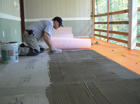

To keep the thinset from drying before I was able to embed the membrane in it, I prepared everything before I mixed it up. First, I rolled out and dry-fit the strip. Before rolling the cut piece back up, I also marked along the edge so that I’d know where to stop the thinset as I spread it over the backerboard. Being careful not to move the membrane, I set concrete blocks on top of one-half of it to anchor it in position. Then I rolled the other half up.
Unmodified thinset applied with a ¼-inch square-notched trowel was used to adhere the membrane to the backerboard. Working quickly, the author spread the mortar to the lines drawn to mark the position of each piece of membrane, combed it with the notched trowel, then rolled the membrane back into place.
John Carroll Unmodified thinset applied with a ¼-inch square-notched trowel was used to adhere the membrane to the backerboard. Working quickly, the author spread the mortar to the lines drawn to mark the position of each piece of membrane, combed it with the notched trowel, then rolled the membrane back into place.

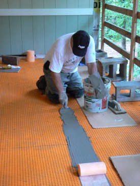

I mixed up one-half of a 50-pound bag of thinset, which was just enough to install the rolled-up half of the strip. Working quickly, I spread the mortar to the line I had drawn and combed it with my notched trowel. After getting the mortar evenly spread, I rolled the membrane back over it. Starting in the middle of the section, I used two hand floats to press the membrane into the mud. Doing this from the inside out makes it easier to avoid bubbles in the membrane. After getting the first half of the strip embedded, I rolled back the second half and repeated the process.

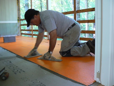

Then the author used hand floats to press the membrane into the mud, working from the inside out to make it easier to avoid bubbles in the membrane.
John Carroll Then the author used hand floats to press the membrane into the mud, working from the inside out to make it easier to avoid bubbles in the membrane.
After embedding the first half of each strip of membrane in the thinset, the author rolled back the second half and repeated the process.
John Carroll After embedding the first half of each strip of membrane in the thinset, the author rolled back the second half and repeated the process.
After I finished installing the membrane, there were several details to attend to before I could begin laying tile on it. First, I had to tape the seams with 5-inch Schluter Kerdi-Band embedded in unmodified thinset. Kerdi-Band, which is made of the same material as Kerdi membrane, comes in rolls up to 33 feet long. As with the backerboard, the process of taping these seams is a lot like that of taping drywall seams.
The author taped the membrane seams with 5-inch Schluter Kerdi-Band embedded in unmodified thinset. The process of taping these seams is a lot like that of taping drywall seams and can be done with the same tools.
John Carroll The author taped the membrane seams with 5-inch Schluter Kerdi-Band embedded in unmodified thinset. The process of taping these seams is a lot like that of taping drywall seams and can be done with the same tools.

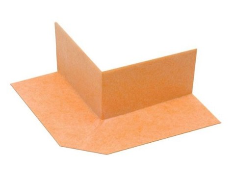

I also used a Kerdi product to flash the most vulnerable spot on this deck for water intrusion: the base of the single post along the open side of the porch. Water that happens to blow into the area above the post flows down the surface of the tile and into the post, so it was imperative to make the flashing there watertight. To achieve this goal, I used four preformed Kerdi outside corners. As with the wall flashing, I embedded these seamless corners in thinset spread over the Schluter-Ditra membrane and up the side of the post. I later covered the vertical leg of the flashing with the cladding I used to finish the post.
Schluter Kerdi-Kereck preformed outside corners were used to flash the post-to-membrane intersection. They cost about $6.00 each.

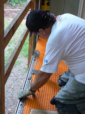

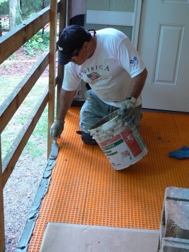

The final task to get the membrane ready for the tile was to install a metal edge along the open side of the porch. Schluter Systems offers several profiles for the outside edge of balconies but the one I chose—called the Schluter Rondec-Step profile—is usually used to finish the nosing on tiled steps. I picked this one because it wrapped down over the exposed edges of the plywood, the backerboard, and the membrane, and because it did not project too far beyond the outside edge of the porch, which worked well with the post.
To finish the open edge of the porch, the author installed Shluter's  Rondec-Step metal trim, first spreading a bed of thinset over the membrane.
John Carroll To finish the open edge of the porch, the author installed Shluter's Rondec-Step metal trim, first spreading a bed of thinset over the membrane.
After pressing the trim into place in the mud, the author placed a concrete block at each end to hold it in place while the mud set up.
John Carroll After pressing the trim into place in the mud, the author placed a concrete block at each end to hold it in place while the mud set up.
To install the metal trim, I spread a swath of thinset and pressed the piece down into the mud. To hold it in place while the mud set up, I placed a concrete block at each end.

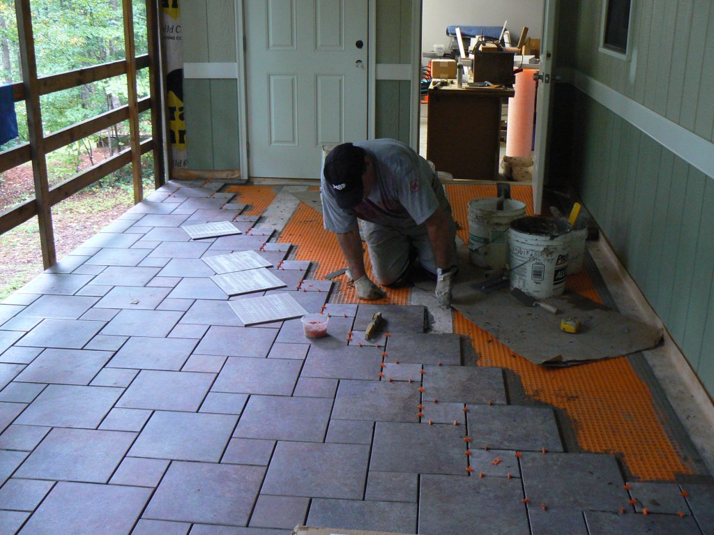

The owners chose a porcelain tile that they wanted installed in a pinwheel pattern. This pattern requires two different sizes of square tiles; usually (but not always) one tile is twice as big as the other. In this case, the large tile was 11 3/4 inches square and the small tile was 5 3/4 inches square. With a 1/4-inch mortar joint, the size of the increments for the layout ended up an even 12 inches and 6 inches.
The porcelain tile used to finish the floor was applied in a pinwheel pattern, which requires two different sizes of square tiles. Usually (but not always) one tile in this pattern is twice as big as the other. In this case, the large tile was 11 3/4 inches square and the small tile was 5 3/4 inches square. With a 1/4-inch mortar joint, the size of the increments for the layout ended up an even 12 inches and 6 inches.
John Carroll The porcelain tile used to finish the floor was applied in a pinwheel pattern, which requires two different sizes of square tiles. Usually (but not always) one tile in this pattern is twice as big as the other. In this case, the large tile was 11 3/4 inches square and the small tile was 5 3/4 inches square. With a 1/4-inch mortar joint, the size of the increments for the layout ended up an even 12 inches and 6 inches.

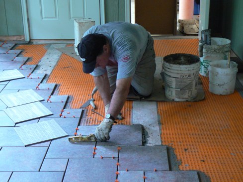

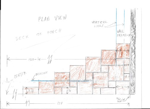

Layout. The first step in laying out the pinwheel pattern was to establish a baseline along the bottom, open side of the porch. I marked the baseline at a distance equal to one large tile (11 3/4-inches) up from the metal edge I’d set at the bottom of the porch.
Next, I found the optimal starting point along the line. This starting point centers the layout between the side walls and makes sure that the cut tiles along the walls are as big as possible. To accomplish this goal, I needed to create a reference at either the center point or a distance away from that center point that equals half the width of the layout increment. Because the smaller tile was 6 inches wide, the layout had to be executed in 6-inch increments. So, if I needed to shift the reference point over, the amount of that shift would be 3 inches.
The distance between the two finished walls was 262 inches. By measuring from the finished faces of the walls, the bottoms of which were cut off a few inches above the floor, my layout on both sides was ¾ inch in from the sheathed walls of the frame. Following this layout maintained a healthy expansion joint around the perimeter of the tile floor. After finishing the tile work, we covered the gap around the perimeter of the floor by building out the wall with a filler and then installed a baseboard. To allow for movement, we held both up slightly above the tile.
To find the center point, I divided the overall length (262 inches) in half and marked 131 inches in from one wall. To double-check my layout, I measured in from the opposite wall as well to verify that this distance was also 131 inches. Next, I divided the 131-inch layout by 6 to see whether to keep the reference point on the center or to move it over 3 inches. This simple computation revealed that there would be 21.83 six-inch increments in that distance. Since .83 is greater than one half, I left the starting point in the center.Once the reference point on the line was established, I had the option of moving the reference over in 6-inch increments and using any of those points as a guide to start the tile work. In this case, I moved over twenty 6-inch increments—or 120 inches—to the right. After marking that point on the line, I marked a line running perpendicular to the baseline from that point. Next, I marked a second perpendicular line 6 inches to the right of the first one.
The first tile installed was a large tile, with the right side cut at 11 inches, the left side even with the left vertical layout line, and the top of the tile even with the baseline. The second tile was cut to 5 3/4 inches and installed against the metal nosing and to the left of the first tile. Next were two full 6-inch tiles and a the third 6-inch tile that had to be cut to 5 inches to fit between the wall and the right vertical line. Succeeding courses were installed in a similar fashion to maintain the pattern.
John Carroll The first tile installed was a large tile, with the right side cut at 11 inches, the left side even with the left vertical layout line, and the top of the tile even with the baseline. The second tile was cut to 5 3/4 inches and installed against the metal nosing and to the left of the first tile. Next were two full 6-inch tiles and a the third 6-inch tile that had to be cut to 5 inches to fit between the wall and the right vertical line. Succeeding courses were installed in a similar fashion to maintain the pattern.

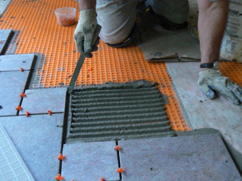

Using the baseline and those two perpendicular lines—which I usually call vertical lines—as guides, I began running the tiles in roughly a diagonal pattern. Here’s how I got the pattern going. The first tile I installed was a large tile. I cut the right side at 11 inches and installed the left side even with the vertical line on the left and the top of the tile even with the baseline. For the second tile, I cut a large tile at 5 3/4 inches and installed it against the metal nosing and to the left of the first tile. Now, I installed three 6-inch tiles; the first two went to the left of the big tiles I had just installed and the third, which I had to cut at 5 inches, went along the vertical line on the right. On the next course, I installed five large tiles, cutting the top and bottom tiles to maintain the pattern.

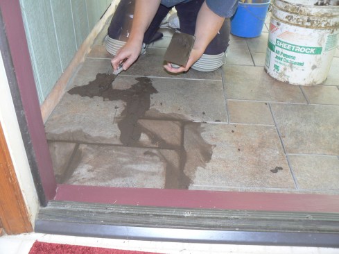

The author set the tile in unmodified thinset applied with a ½-inch-by-½-inch notched trowel.
John Carroll The author set the tile in unmodified thinset applied with a ½-inch-by-½-inch notched trowel.

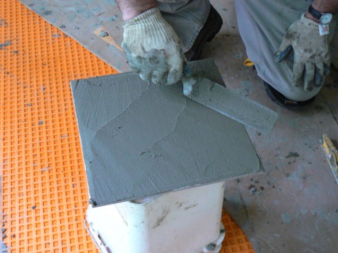

To ensure enough coverage over the waffled surface of the Schluter-Ditra membrane, the author also back-buttered every tile.
John Carroll To ensure enough coverage over the waffled surface of the Schluter-Ditra membrane, the author also back-buttered every tile.
After the tile was set,the joints were grouted with a sanded grout, using standard tile-setting techniques.
John Carroll After the tile was set,the joints were grouted with a sanded grout, using standard tile-setting techniques.
Installation. Then I was off to the races. By alternating between a course of large tiles and a course of small tiles, I gradually built a large stair-step-shaped installation pattern that ran the full width of the porch. To keep the pattern straight and orderly, I used ¼-inch tile spacers throughout the job.
In keeping with the manufacturer’s recommendations, I set the tile in unmodified thinset mortar. The tile manufacturer recommended a ¼-inch-by-¼-inch notched trowel, but I found that this didn’t provide enough coverage over the waffled surface of the Schluter-Ditra membrane. After some experimentation, I ended up using a ½-inch-by-½-inch notched trowel, and I also back-buttered every tile. After setting all the tile, I grouted the joints with a sanded grout.

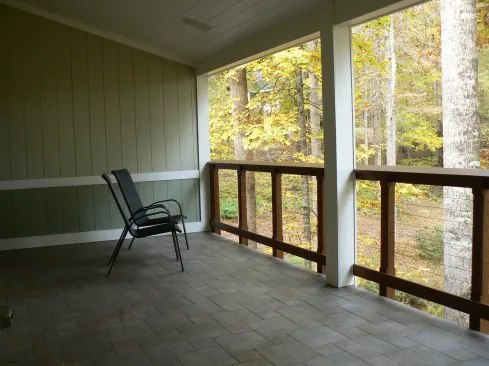

Even after four years of use, the porch floor looks as good as the day the tile was installed.
John Carroll Even after four years of use, the porch floor looks as good as the day the tile was installed.
The underside is open to view and there are no signs of water leaks anywhere.
John Carroll The underside is open to view and there are no signs of water leaks anywhere.
Follow-up
The porch floor has been in use now for four years and looks as good today as the day I finished it, with no sign of water leakage anywhere underneath the deck. For this project, the D-EXT-W-13 specifications have worked exceedingly well, but I’ve since learned that this detail is no longer included in Schluter’s literature. A technical representative told me that the company dropped these specs because some installers experienced leaks, but in his opinion, the cause of the leaks was a failure by the installers to carefully execute vital flashing details.
Would I use this system again? I would—but only if the deck had a roof over it. If I were building a deck that was completely open to the weather, I would follow the more conservative (and expensive) D-EXT-OS-15 specs, which are now the only specs that Schluter Systems provides for tiling over a wood-framed deck.
