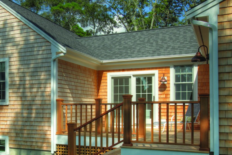

Narrow overhangs rely on gutters to help keep water off the siding.

Narrow overhangs (12 inches or less) generally look better with steeper-pitch roofs and more classic designs. Narrow overhangs don’t offer much shading, and they do not offer nearly as much protection against rain. Where I live in New England, most narrow eaves are equipped with gutters to collect roof runoff.

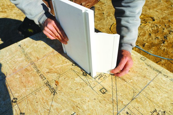

Visualizing the details of eaves is easier with a full-scale drawing. For this complex eaves with crown molding, the builder uses a section of the molding along with a piece of 1-by stock to ensure a proper layout.
Justin Cline
Make a full-scale drawing. Once the design is completed and put on the blueprints, most framers I know make a full-scale drawing of the eaves detail on the end of a straight piece of rafter stock or piece of sheathing. They begin by drawing the birdsmouth, or the rafter cut out that fits over the wall plate (see “Cutting Common Rafters,” Mar/17). From there, they mark out the total overhang as taken from the plans. Working back from the overhang, they mark the width of the fascia and any secondary fascia trim that might be called for. Next is the subfascia, which is usually made from 2-by stock that is nailed to the rafter tails.
Going back to the fascia board on the drawing, framers mark the height of the board as determined by the design and by stock widths. (For 1×8 fascia, they would mark 7 1/2 inches down from the top). Then they mark the reveal along with the thickness of the soffit material. The top of the soffit material and the inside edge of the subfascia help define the cut lines for the rafter tails.
A full-scale drawing is particularly important when the plans call for a cornice with crown molding (see “Building a Cornice,” Apr/17). Because crown-molding angles can vary, it’s helpful to have a sample of the material you plan to use on hand as you make your drawing. Some builders make their full-scale drawings and mock-ups on a sheet of plywood and work out the cornice returns as well.

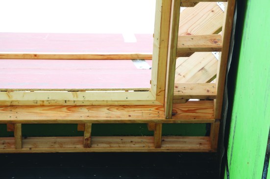

Seen from below, blocking between the subfascia and the wall adds plenty of nailing surface for attaching a wider soffit.
Eaves with wide overhangs. Most wide soffits are made from sheet goods ripped to the proper width. We used to make those soffits from 3/8-inch AC plywood. Wide soffits require some sort of nailer in the form of a cleat or blocking along the wall of the house. Wide soffits may also benefit from blocking that runs between the wall ledger and the subfascia. That blocking is typically nailed to the sides of rafter tails.

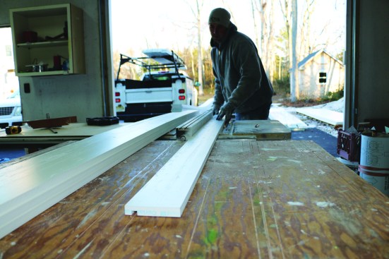

To join the fascia to the soffit, this crew member runs the 1-by fascia material through a table saw to create a dado groove.
Justin Cline
Methods for attaching the soffit to the fascia vary depending on the material. For thin plywood soffits, the preferred method is cutting a dado or groove along the reverse side of the fascia. The fascia dado for 1/4- or 3/8-inch plywood can be made with a couple of quick, shallow passes on a table saw. When you’re attaching the soffit to the nailers, the outer edge extends past the subfascia by 3/8 inch or so. The dado in the fascia then slips over the protruding soffit and captures the edge of the material. The dado groove also provides some leeway to adjust the straightness of the fascia. If thicker soffit material, such as 1-by stock, is used, a wider dado can be cut, or the soffit can be joined to the fascia with a simple butt joint.
