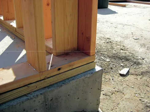

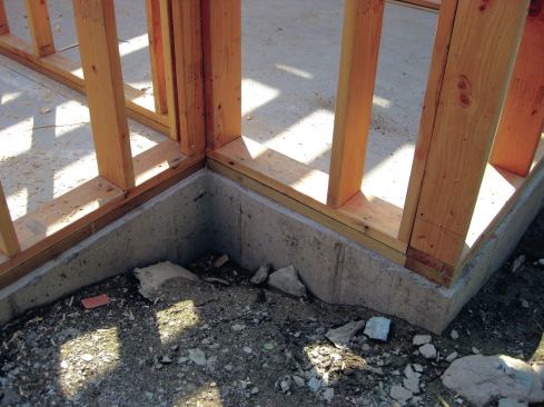

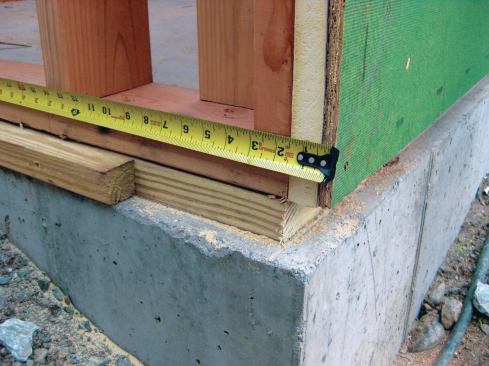

Framing. The slab wavered up to 1/2 inch in places along the longest wall, so we decided to set the foam sill seal and PT 2x6 mudsills back 1 1/2 inches off the edge of the concrete. This setback would also help protect the exposed edge of the insulation from rodents and insects. Although the R-Sheathing specs allow for 24-inch on-center spacing, we switched to 16 inches for the 2x6 exterior walls because we wanted the extra nailing. We framed "California" corners instead of adding an extra stud nailer, and we accounted for the panel thickness in the wall layout so we could install full-width 4-foot panels at the corners.
To save the labor of cutting a couple hundred studs, we decided to use 92 5/8-inch precuts. And so we wouldn't have to add blocking for nailing at the top of the wall, we planned to align the bottom edge of the R-Sheathing with the bottom plate of the wall, then fill in with PT strips at the mudsill and strips of sheathing at the second top plate. We realized after the building was mostly dried in that the sheathing did not connect the wall framing to the mudsills, which were bolted to the concrete. I'm currently working with the architect to come up with a solution, and I may have to go back and install additional anchor bolts through both the bottom plate and mudsill to pass inspection.

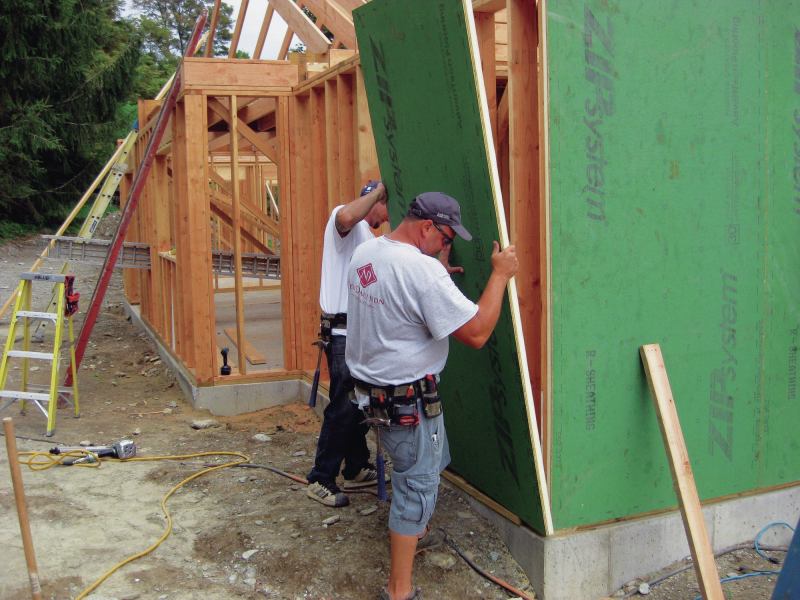

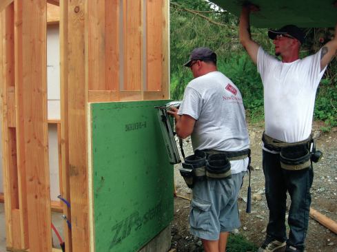

Installation. We used 1 1/2- by 1 1/2-inch PT spacers as stand-offs to help put up the panels. A full sheet is fairly light, but it's a two-man job install, especially at the outside corners where the panels lap each other. We took time to square them up properly. It's important to orient panels the same way and to work in one direction because the foam overhangs the OSB slightly on one long and one short edge to ensure proper gapping. In a few places, we installed panels horizontally to save material; this meant adding horizontal blocking for edge fasteners.

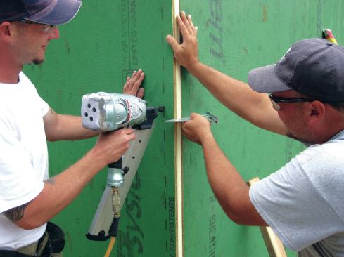

Fastening. We used full-head 3-inch, 0.131-diameter, smooth-shank collated stick-framing nails (bostitch.com), which met Huber's fastening specs, and followed nail-spacing requirements of 4 inches on-center at edges, 12 inches in the field. We nailed at a deliberate pace, trying to drive the nails slightly below flush, but being careful not to overdrive. (We taped any overdriven nails in the field.) We hammered flush any nails standing proud in the field, but avoided this at the edges where hammering can compress the foam.
Taping. The main difference in taping R-Sheathing stems from its added thickness. We used Huber's 6-inch–wide Zip System Tape at outside corners, which provided the required minimum 1-inch lap onto the OSB. For the rest of the seams, we used 3 3/4-inch–wide tape. (See "On Site With Zip System Sheathing," Feb/11, for more information about taping.)

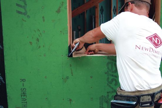

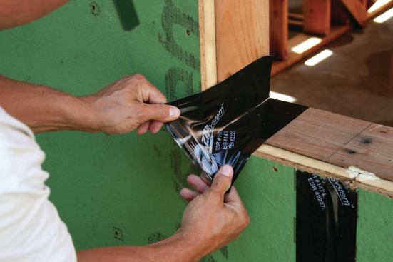

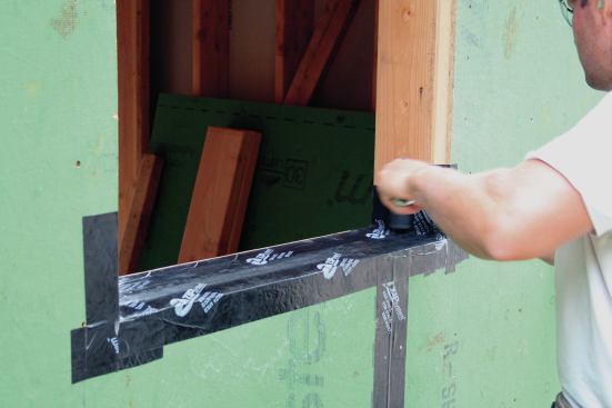

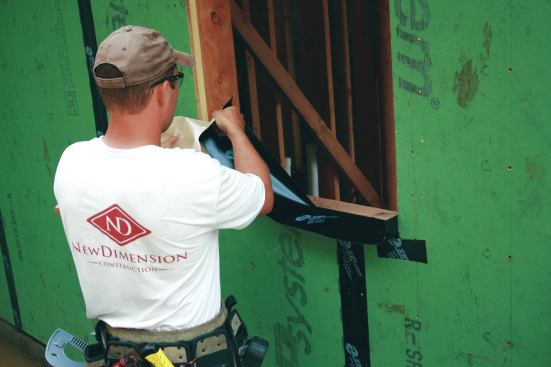

For the windows, we set up a mobile cutting station to cut tape for the head, jamb flashing, and the four-piece pan. We started at the pan flashing, using Zip System's corner/valley tool to set 9-inch lengths of 6-inch tape in the corners, with 3 inches on the sill and running up the trimmer, and the 9-inch dimension flush with the inner edge of the 7-inch–deep sill. This left 2 inches overhanging the sheathing, which we stretched and pressed onto the panel face. This doesn't always work perfectly, but corner flashing gets covered with the next couple of pieces, plus sealant under the window's nailing fins.

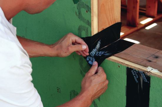

Next, we ran 6-inch tape the full length of the rough opening, plus 2 inches up each trimmer. This piece is adhered half at a time. First, fold it to half its length, peel back the release paper on one side, and press it onto the sill with the fold on the centerline mark and the outer edge overhanging the sheathing by about 2 inches. Burnish the tape with the corner/valley tool, including the 2-inch vertical legs, then peel back the other half and adhere it to the sill and trimmer. Make a 1 1/4-inch cut down the 2-inch vertical legs and stretch the overhanging strip of tape down onto the panel surface.
Now install an 8-inch length of counterflashing tape in each corner, first adhering a 6-inch leg vertically, then the 2-inch leg horizontally. This piece should also overhang the sheathing by 2 inches, so cut and stretch it as before, and press it onto the panel face. Finally, cover the remaining exposed sill with a second full-length strip running across the sill and 2 inches up the trimmer, then roll the entire pan using the Zip System J-roller.

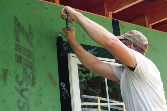

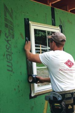

When installing the windows, we put a healthy-sized bead of sealant about 3 inches back from the sill's edge to act as a dam. With the windows in place, we applied a strip of tape at each jamb, running it about 3 inches above and below the window frame. Lastly, we applied the head flashing and rolled everything with the J-roller.
