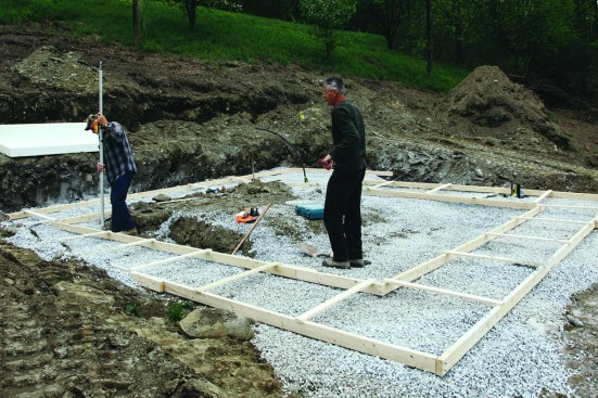

Excavation and footing. The first step is excavating for the foundation assembly. With the excavation open, the crew can put down a layer of crushed stone. The crew sets up 2x4 forms for the footing, using a laser to make sure that they are perfectly level.

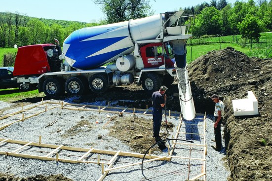

After the crew stakes the forms in place, a concrete truck carefully fills them.

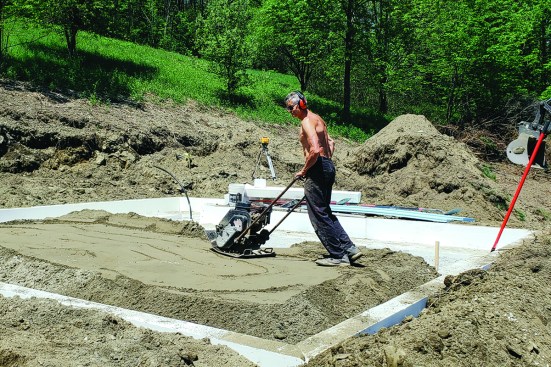

Next, they even out the ground inside the forms with a fresh layer of crushed stone, compacting the layers as they go.
Mitch Frankenberg

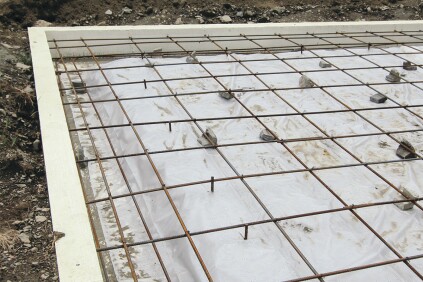

Rebar grid. A grid made from 1/2-inch rebar forms the reinforcement layer for the monolithic slab. The ends of the bar insert into the foam, and pieces of CMU act as chairs for the grid to sit on.
Tim Healey
Each intersection is wire-tied together and anchored to the vertical rebar sections. An additional layer of rebar below the main layer reinforces the built-up edge of the slab.

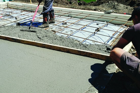

Slab placement. The concrete crew places the slab, screeding the mix flush with the top of the forms.
Mitch Frankenberg

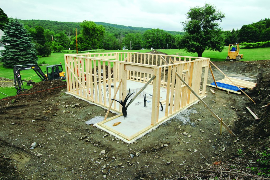

The treated sills for the walls attach to the slab with concrete screws for positioning. Embedded J-bolts around the perimeter of the slab provide
permanent anchoring for the framing.
Tim Healey
The treated sills for the walls attach to the slab with concrete screws for positioning. Embedded J-bolts around the perimeter of the slab provide permanent anchoring for the framing.
