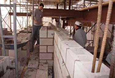

The blockwork was on the critical path; the floor and roof framing could not be completed without it in place. After we built one wall to the next floor height, we removed our scaffolding to allow floor framing to proceed. Meanwhile, we moved to work on the other gable. We started work in the middle of winter and ultimately performed about half of this job under winter conditions.
We began by staging both sides of the wall with pipe scaffold and enclosing the perimeter with translucent, fireproof tarps. (Regular poly sheeting, like the blue tarps used everywhere else and commonly used to enclose work areas, is highly flammable and poses a serious risk to workers. Back when I was an apprentice, I witnessed a blue poly tarp enclosure go up in a flash, ignited by an open-flame heater. The crew was fortunate not to have been inside at the time.)
We bridged the span between the staging with “putlogs” — steel scaffolding beams made for this purpose — then decked it over solid with planks, plywood, and more fireproof tarps. This temporary roof completely covered the work area and prevented the tarps from sagging under rain and snow loads. We kept the enclosed area comfortable with propane heaters, which run clean and are easy to maintain.
To protect the sand and cement — not to mention the laborers mixing the mortar and grout — from extremely cold weather, we also set up a heated mortar shack adjacent to the enclosure. Because the construction specifications prohibited all use of winter additives in the mortar and grout, we heated the sand and water prior to mixing. We used an electric-powered 400-pound-capacity Imer mixer (800/275-5463; www.imerusa.com) to eliminate the fumes otherwise produced by a gas-powered mixer. Thus set up, the masons worked through snowstorms and below-freezing temperatures in safety and comfort.
Building a Monolith
Block lay-up began at basement level over a poured concrete footing that measured 36 inches wide by 12 inches thick. Since the footing was placed by the foundation contractor over both undisturbed grade and compacted fill, it was reinforced with various sizes of horizontal rebar. We set L-shaped 18-by-36-inch #5 rebar ties every 16 inches o.c. to coincide with the block cells, connecting the block wall to the footing. The rebar became locked in later, when we grouted the block cells solid.
