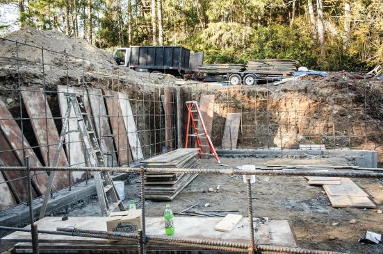

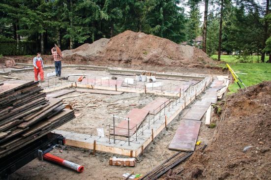

Before we form any walls, we scatter our 2-foot-by-8-foot MDO (medium density overlay) Plyform panels along the outside and inside of the footings. These forms are actually made of plywood, with a special MDO facing that increases their durability and prevents the grain of the plywood from transferring to the concrete. Plyform panels are available in various thicknesses; the ones we use are 1 1/8 inches thick and very heavy, so scattering them in advance allows us to simply roll them over and into place as we work.

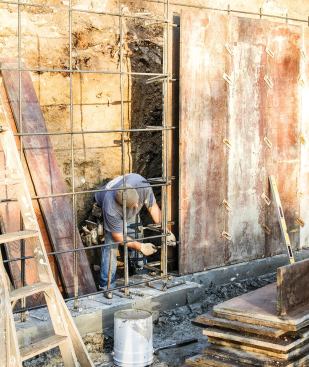

Following the engineer’s plans or prescriptive guidelines, we connect wall rebar to the rebar already installed in the footings. In our area, the schedule for 2-foot-tall walls — the size we typically build — calls for vertical rebar 48 inches on-center, with a single continuous horizontal rebar at the top of the wall. Taller walls require more steel.
We work in two-man teams when forming walls, preferably with a third laborer available who can find — or cut — pieces as we go. Since the Plyform panels cost about $40 apiece, we’re reluctant to cut them to fit. Usually we don’t have to, since we’ve accumulated an assortment of sizes over the years. We also won’t cut a piece of panel to fit gaps that are less than 1 foot wide. Instead, we span these short gaps with sections of galvanized sheet metal that we keep on hand just for this purpose.

When we formed the footings (as described in Part I of this article), we installed Rap-I-Form metal form clips (awardmetals.com) in the wet concrete. As we assemble our form, we place additional form clips on the footing so every panel will have a clip within 2 to 4 inches of each end, to keep the panel ends from spreading. At the top, we clip only enough to hold things together while we form. Later, we’ll come back and add enough clips so that they are spaced about 2 feet apart.

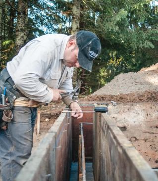

We set the second or third row of panels on snap ties laid across the tops of the lower forms, following the same spacing as our form clips. Wedge-shaped “shoes” driven between the snap ties and the forms tighten them against the ties’ internal washers. The ties leave a 3/16-inch gap between the forms where the water will leak out as we pour, but we just scrape the overflow off, and the gaps make it easier to strip the forms.

When walls are taller than 6 feet, we orient our forms vertically. This requires closer spacing of the form clips on the footing to prevent the bottom of the wall from blowing out under the load of the concrete, and we make sure clips are placed an inch or two from each panel edge. Vertically, we place snap ties in slots cut at 1-, 2-, 4-, 6-, and 7-foot intervals along the long edges of the panels. This has proven to be a good spacing for keeping the panels from bulging as the concrete is placed.
If we are pouring a 9-foot-high wall, we stack one-foot-wide panels on snap ties at the top. When pouring 10-foot-high walls, we stack 2-foot-wide panels on top.
At inside corners, we drill through the inside panels and poke snap ties out on the same 1-2-4-6-7 spacing so that these weak points have plenty of support. To make sure there’s enough room for wedges, we space the holes about 3 inches off the inside corner. We reinforce outside corners with metal plumber’s strapping about every 2 feet vertically. Then we line the tops of the walls to make sure they are straight, brace them as needed, and double-check the diagonals.

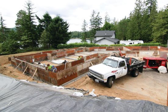

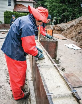

The pour. The line pump operator controls both the speed and the accuracy of the pour. But I can help him by assigning a crew member to work with him, mainly to make sure he keeps the concrete right at the elevation line. Meanwhile, I watch the forms. Usually only two of us need to be on site for the pour, but if the walls are taller than 4 feet, I like to have an extra guy on hand to minimize the need to climb over the forms or in case something goes wrong.
Since the concrete mix that comes out of the line pump is super smooth, we don’t need to vibrate the forms. If we’re using a regular mix with larger aggregate, we work the concrete as we go, shoving a 1-by up and down into the forms to move the water to the edge.
After the concrete has firmed up for 30 minutes or so, we trowel the top smooth, then set our J-bolts or Simpson MASA mudsill anchors (which we prefer) about 48 inches on-center. If hold-down bolts are specified, we’ve already placed them in the forms using Simpson AnchorMate Anchor Bolt holders (strongtie.com) prior to the pour.

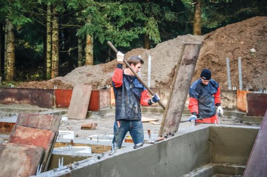

Before leaving for the day, we scrape any wet concrete off all of the inside corners and from the top of the footings to make stripping the walls easier. Depending on the time of the pour and the weather, we’ll either come back to strip the walls the next day or wait a couple of days to let the concrete firm up. Afterward, we oil the daylights out of the forms before storing them at our shop under tarps. The forms last forever if they’re taken care of.
