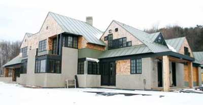

In Europe — where wood-frame construction is an anomaly rather than the norm — precast concrete panels have been used for residential construction for at least a couple of decades. In the U.S., they're more commonly associated with commercial projects, from office buildings, dorms, and parking garages to multifamily housing. But as concrete construction (a category that includes ICFs, masonry and block, and tilt-up panels) becomes increasingly popular, more and more precast plants are marketing their products to developers and custom-home builders.
Once you get past the fact that you can't cut it with a Skilsaw, there's a lot to like about precast concrete. Like SIPs, the engineered panels are manufactured under controlled conditions and are therefore predictably strong, and they can be quickly assembled with minimal skilled labor, even in bad weather. Moreover, they're fire- and storm-resistant, energy-efficient, and easy to maintain.
To get a better idea of how precast concrete panels are manufactured and how they fit together on the job site, I recently visited a precast plant and spent several days following the progress of a custom home being built with the panels. Here's what I learned.

Precast concrete walls are less common in residential construction than hollow-core plank decks, and they require longer lead times — eight to 10 weeks at the Carrara precast plant — and considerable coordination between the designer, the GC, and the panel fabricator.
The architect on this project, Jim Sanford (also of Middlebury), had already collaborated with the Carrara plant on several precast projects and so was familiar with the connection details that would be needed between the concrete panels and the wood framing and millwork used to finish the house. Working from Sanford's architectural plans, the fabricator's engineering team prepared shop drawings for each panel.
Panel design. A few different types of precast wall systems are available, including solid-wall and double-wall panels. In special casting beds at its plant, Carrara forms solid-wall precast panels for uninsulated walls and insulated sandwich panels for enclosing conditioned living space.
