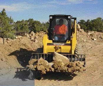

Choosing a Brand
Skid-steer loaders come in several different brands. Which one to choose is entirely a matter of what you like and what your business needs.
Operating conditions are severe for my excavation business, and minimizing downtime is a priority. So I bought a Caterpillar, the machine that I think is the strongest and most comfortable. In addition, it has the best parts availability and the highest resale value, and I’ve had positive experiences with other machines made by the same company. Not surprisingly, the Caterpillar is also one of the more expensive skid steers.
I have used other brands, so I was able to make comparisons before making my decision. One of the greatest benefits of the Cat is its piloted hydraulic controls, which make a huge difference in operation, especially as the machine ages. Less expensive machines have cable-operated controls, which tend to degrade over time: When they get dirty, frozen, worn, or stretched, it becomes much more difficult to control the machine, which increases the likelihood of causing serious damage on a close-quarters residential construction site.
Cheaper machines also have lower-quality bushings and wear parts — and regular repairs can quickly eat up any up-front cost savings.
Still, not every user requires a top-of-the-line machine. If your skid steer will see only occasional use, or steady use under light conditions, you should be able to spend less and get satisfactory results. For such buyers, the best advice I can give is to talk to other skid-steer owners about their experiences and their dealers.
Also, demo or rent machines from at least three different manufacturers before you buy. Most equipment dealers are willing to let you try the machine; often they’ll even bring it to your site.
