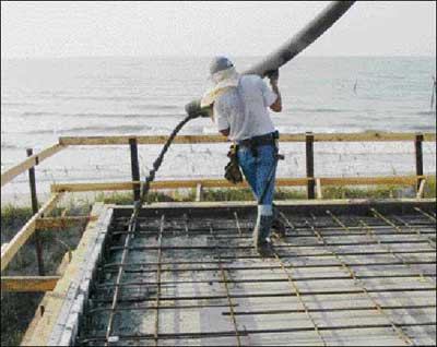

Using specially designed sets of removable aluminum forms, crews for Security Building Group can form and pour houses on the beach a story at a time, including the walls and floor slab.

When the pour finally happens, it goes fast — and Pfanmiller says that the concrete supplier needs to be prepared to keep the concrete flowing without interruption. “We absolutely don’t want a cold joint in a wall,” he explains. (A cold joint occurs when concrete in a form starts to set and harden before the next lift of concrete is placed next to it, creating what could be a critical weak spot.) “This can be a challenge with some ready-mix companies, because when we order 50 yards we want five 10-yard trucks in the street before we start the pour. Some of them are used to sending you two or three trucks, and then cycling back the first two, but we can unload 10 yards of concrete in 15 minutes, so we can’t wait for those trucks to cycle back.”
There’s an upside to this for the supplier. “It’s also our selling point for the ready-mix people and the pump people. We tell them that if we have a pour of 50 yards — five 10-yard trucks — scheduled for 8:00 in the morning, we will have the five trucks and the pump off the job by 9:00.”
