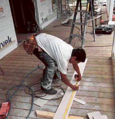

I’ve been a carpenter for more than 20 years, but I only recently installed fiber-cement siding for the first time. When JLC asked me to try out some of the portable tools for cutting fiber-cement siding and trim, it was an opportunity too good to pass up: a chance to check out the tools without risking a bad purchase.
Cutting fiber cement with a circular saw blade is like producing your own personal dust storm — definitely not the most pleasant environment to work in. I’m not afraid of getting dirty, but fiber-cement particles are very small and especially irritating to sinuses, skin, and eyes. So it’s natural that manufacturers would be keen on developing tools that cut cleanly and quickly, without the dust.
