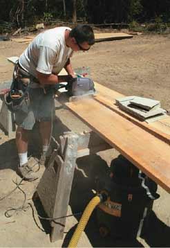

Cut Station
Our cut station consists of a pair of sawhorses with a work surface — a couple of sacrificial planks — on top. The vacuum and saw plug into an I-socket 110m (DGC Products, dgcproducts.com), a switch that activates the vac when the saw comes on. In order to clear the hose, the switch runs the vac for several seconds after the saw cuts off.
The addition of the vac and hose makes the cut station harder to move, so we cut as much siding as possible — an entire side of a house, for example — before changing locations. To save time we stack the material and gang-cut multiples.

Makita 5057KB
The 5057KB was clearly designed for collecting dust: Without obscuring the cut line, its plastic shroud almost completely covers the blade, kicking the particles and dust to a compartment in the rear that can be emptied through a flip-up door. The saw can be used with or without a vac. Connected to a good vacuum, it captures probably 90 percent to 95 percent of the dust. You can use it without a vac by covering the port with the included cap, but you’ll mainly collect only the heavier particles; the finer stuff still gets into the air.
