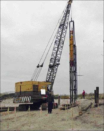

We primarily build custom homes on the shifting sands that comprise the barrier islands of the New Jersey coastline. Timber piles serve as the foundation, or support the footings for a masonry foundation, on every home we build. For all oceanfront homes in the V zone, the new FEMA regulations require a tip depth of minus 10 feet (that is, 10 feet below sea level). Average grade elevations of plus 8 to plus 10 feet and finish-floor elevations of plus 16 feet are common. As a result, we are typically driving 25- to 30-foot-long timber piles with a butt diameter of 10 to 12 inches. And more than almost anything else we do, this work presents an enormous liability risk, largely because of the kind of communities we work in.

When a 1,500-pound drop hammer is falling from 10 to 15 feet, hitting the butt of a 25-foot timber pile a few hundred times, and you have 70 or 80 piles to do, the neighbors tend to get up in arms no matter how charmingly you may have introduced yourself. Their biggest concern is whether the process will damage their foundations or cause other damage to their homes. There are many stories of "priceless" items that vibrated off shelves, pictures that fall, and chimneys that crack.
So our next step to alleviate their fears is to meet with them, explain the process we are employing, and ask permission to have our engineer do a structural survey of their home. It's much easier to get access to the neighboring properties before anything happens than it will be after something goes wrong. We need to assess the condition of their foundations. We are trying to determine if there are any signs of settlement, cracks in the foundation, signs of settlement on the interior, doors that don't close, separation of the chimney from the structure, signs of water intrusion, cracked windows, or other such problems, so that we won't get unfairly blamed for these after our work begins.

On the job next to the English Tudor house mentioned previously, our report saved us from having to rebuild and replace 30 feet of landscaping walls, as we were able to prove the condition existed before we started. We were certain our work had not caused the slightest movement of these walls because we monitored it carefully throughout the job. The report also alerted our piling contractor to take exercise great caution near these walls: He first air-jetted the piles as close to the final depth as possible and only drove the last couple of feet — just enough to reach the required tonnage. At every step, we kept a close eye on his progress, constantly checking the walls for any signs of leaning or shifting. We were fortunate no movement occurred. But if we had noticed any movement, we would have resorted to an alternate "low impact" method, such as using helical steel piles. Even at this point, it would have been more cost effective to redesign the entire foundation scheme than to spend years in court and pay the increases in insurance premiums that could arise from just one claim. ~
