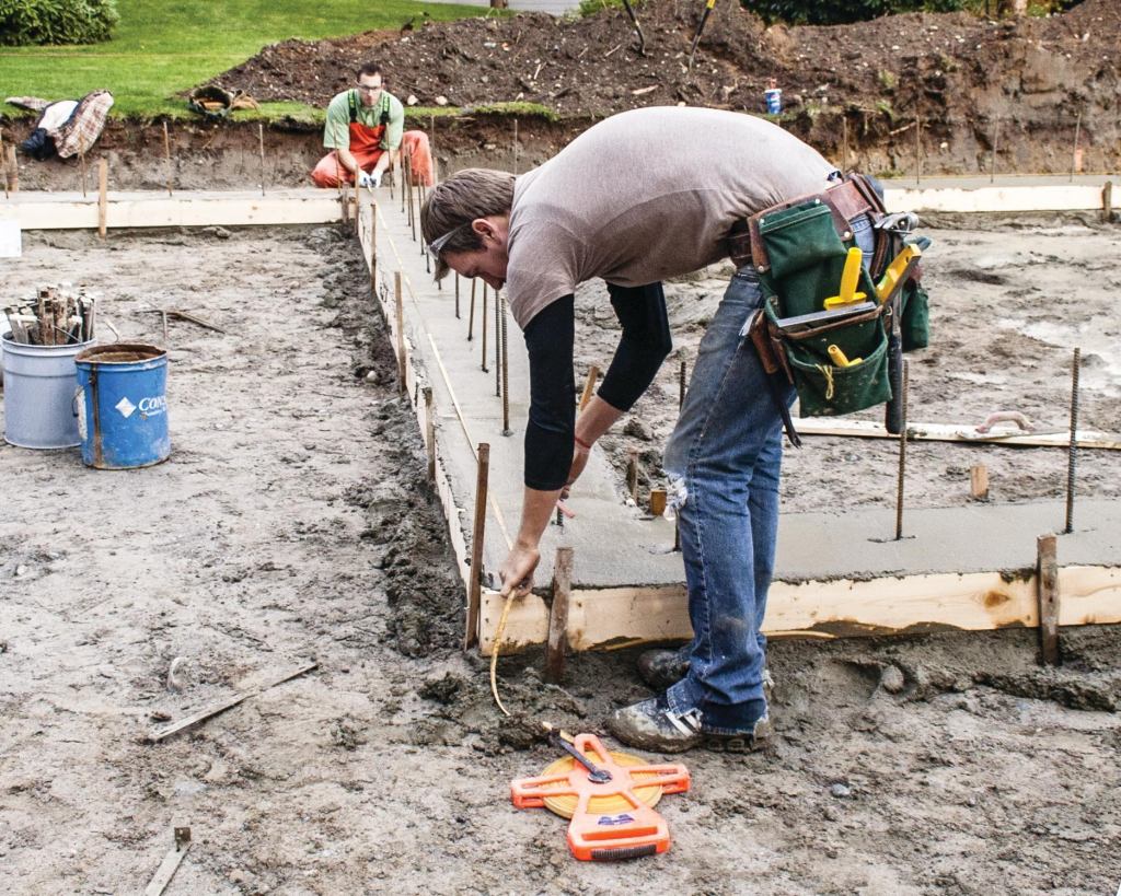

Footing Layout
Footings can be larger than required dimensions, but should not be smaller. Footings should be straight and level to within 1/4 in. over 20 ft., and should be no more than 1/2-in. out of square in 20 ft.

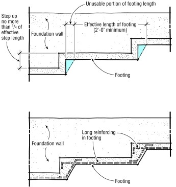

Stepped Footings
On sloped sites, footings must be kept level, so the footings will have to be stepped. Step lengths must be at least 2 ft., step heights must be no greater than three-quarters of step length, and vertical footing sections must be at least 6 in. thick (below).
The rise of a stepped footing should not exceed 2 ft., and the footing should run at least 2 ft. horizontally between steps (at top). Typically, the corners of a stepped excavation are unstable. The footing should be sloped and reinforced, so the effective horizontal length of the footing is supported on well-compacted soil (at bottom).
On slopes too steep for stepped footings of these dimensions, consider a pier-and-grade-beam foundation. See Pier Foundations.

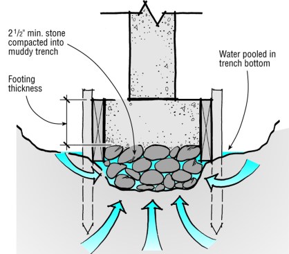

When footing trenches fill up with water in wet conditions, place a layer of well-tamped 3- to 4-in. cobbles (Repairing Off-Center Footings, below) and use a stiff concrete mix when casting the footings.
When water pools in a footing trench, place large cobbles in the bottom of the form, compacting them down into the mud. Muck and water may fill the spaces between the stones, but contact between stones will provide bearing. Use a stiff concrete mix when casting the footings.
