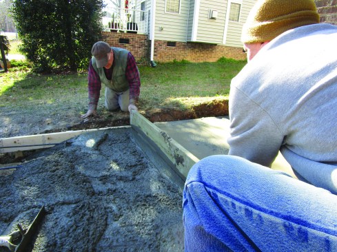

Recently, I mixed and poured a yard of concrete for the footing of a small addition with the help of a friend, who made it a point to remind me that there were big, clunky trucks that will bring concrete to you all mixed and ready to go. Of course, I was well aware of that fact, but as I pointed out to him, those big, clunky trucks cost close to a quarter of a million dollars apiece, and the people who invest in them are not all that interested in selling their concrete a yard at a time.
Most ready-mix concrete companies don’t want their expensive trucks tied up on what they consider tiny pours. Usually, they won’t make the trip for less than a yard, and to make money on these so-called “short loads” (1 to 7 yards), they apply a minimum load charge of around $100. In addition, many concrete companies have time limits of seven to 10 minutes per yard for unloading the concrete.
The extra charges for the concrete are not as bad as they may seem. For example, on a two-yard pour, who wouldn’t pay an extra $100 to avoid mixing up four tons of concrete? The time limits are another matter. Unless the truck can pull up very close to the pour, it can be difficult to unload a yard of concrete—which weighs 4,000 pounds—in less than 10 minutes.
You can line up extra help to unload the concrete, but lining up good help for a backbreaking job like that isn’t always easy, and it can be expensive if the truck doesn’t show up on time. Like any supplier of building materials, ready-mix concrete companies face numerous variables that make it difficult to stay on schedule. And the customer who buys hundreds of yards per month takes precedence over guys like me, who buy only five or six yards every two months. Unfortunately, when the truck is late, I still have to pay my help for the time they’re on the job.
In my world of remodeling and custom masonry work, most pours are inaccessible to a concrete truck. Some pours are also several feet above the ground. The good news is that the majority of my pours are fairly small and I can mix the concrete myself. With my concrete mixer, I can mix up about a half yard per hour, so I don’t think twice about mixing my own concrete for up to one-and-a-half yards.
Working Steadily
While mixing concrete on site is physically demanding, the time pressures are considerably more relaxed compared with those of a pour using ready-mixed concrete. For the footing pour mentioned above, I started by putting a plastic sheet on the ground at the edge of the property. While I dug the footing, I had 41 bags of concrete—at 80 pounds apiece—delivered and stacked neatly on the plastic. At the end of the day, I carefully covered the concrete with a tarp to protect the bags from getting wet.
The next day, I set up my mixer near the concrete stack, and, with everything already set up, I was able to start mixing and pouring just minutes after the inspector approved the footing. With no time constraints, there was no urgency to move the concrete from the truck and into the forms. Instead, my sole employee and I mixed and placed the concrete over the course of a couple of hours in a calm and controlled fashion.
Had we gone the ready-mix route, I would have needed to schedule the delivery after the inspection, and delivery might have been a day or two later. I also would have needed to round up another worker to help unload the concrete in the time allowed, and the three of us might have had to wait an hour or two for the truck to arrive. If it happened to rain between the inspector’s approval and the arrival of the truck, I would have had to pump the water out of the footing, remove the rebar, and scoop up the wet muck at the bottom of the footing before the pour. So while those big, clunky trucks do offer the initial convenience of bringing ready-to-pour concrete to you, they can sometimes bring some big, clunky problems as well.

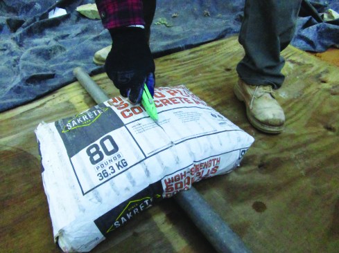

When estimating the number of 80-pound bags of premixed concrete needed, I divide the number of cubic inches needed—in this case 47,104—by 1,150 to determine the number of 80-pound bags needed. The result is 41 bags. So where did I come up with the number 1,150? According to manufacturers, each 80-pound bag produces 2/3 cubic foot of concrete. A cubic foot (12x12x12 inches) is equal to 1,728 cubic inches. Multiplying that number by .667, or 2/3, yields 1,152 inches, which I rounded down to 1,150.

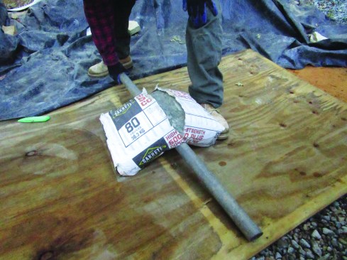

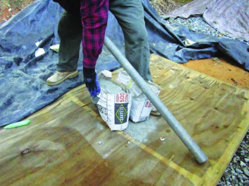

Bagged premixed concrete has many advantages and is convenient. The 80-pound bags can be arduous to handle all
at once, so the author cuts the bags in half. First, he places the bag over a pipe and slits the top paper.
Bagged premixed concrete has many advantages and is convenient. The 80-pound bags can be arduous to handle all at once, so the author cuts the bags in half. First, he places the bag over a pipe and slits the top paper.
Measuring the Dry Ingredients
When mixing 1-2-3 concrete, many masons count shovel loads of each ingredient to make up the recipe. But because I consider a shovelful to be an inaccurate measure and because I find it easy to lose count, I prefer to fill six buckets of equal size with the ingredients. To make a batch of 4,500-psi concrete, I fill one bucket with portland cement, two buckets with sand and three buckets with stone (see photo). If I want stronger concrete, I increase the amount of portland by 50%.
Lifting the pipe splits the contents in half.
It then tears through the rest of the bag, leaving two 40-pound bags.

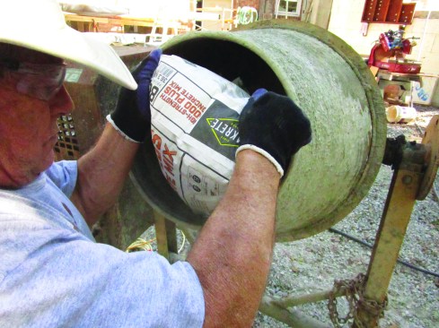

If I’m using premixed concrete, following a recipe isn’t necessary. I can load my mixer with three 80-pound bags, which produces about two-thirds of a wheelbarrow worth of concrete. To save my back, I don’t try to empty a full bag into the machine in one shot. Instead, I cut the bags in half and dump them 40 pounds at a time. To cut a full bag in half, I place it over a length of pipe and slit the bag down the middle. Lifting up the pipe lifts the bag and breaks through the underside of the bag, leaving two half bags ready to dump into the mixer.

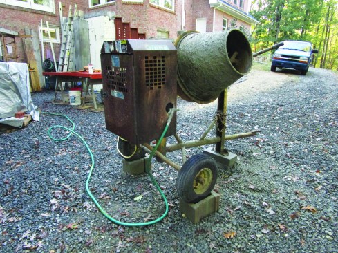

Mechanical mixers are a great way to mix small batches of concrete.
Mixing the Concrete

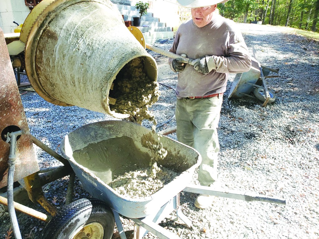

There’s no escaping the fact that mixing and placing concrete is heavy work. For this reason, I always try to set up the job and use techniques that minimize the grunt force required. With all the masonry work I do, one key to saving my back is the aforementioned mechanical concrete mixer. If you find that you’re mixing concrete on site every couple of weeks or even every couple of months, a mechanical mixer can pay for itself quickly with the work that it saves. Mixers can be gas-powered or electric, and they vary in their capacity or volume. Mine is a 115-volt electric mixer. New professional-grade mixers can cost up to $3,000, and new light-duty mixers can cost about the same as a miter saw. With a little shopping, you may be able to find a less expensive, used mixer.
I begin by setting up my mixer on concrete blocks 8 inches high. That height lets me dump the concrete easily into the wheelbarrow. Next, I set up a hose with a pistol-grip nozzle that allows me to control the water flow with one hand. The nozzle can also be hooked on the side of the mixer, so I don’t have to bend down to pick the hose up off the ground every time I need it.

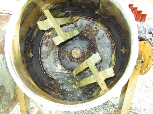

Whether I’m mixing concrete from scratch (using the 1-2-3 formula or a slight variation of it) or from premixed bags, I always start with the water. Inside the drum of my mixer, there is a raised section in the center that forms a ring. I’ve found that filling the drum with water up to the bottom edge of this ring is a good starting point for one load.
It’s important to realize that water is in the mix to cause a chemical reaction called “hydration,” which in turn creates the hardened concrete. The amount of water needed to achieve hydration is surprisingly small—the dry ingredients have to be thoroughly moistened but they don’t need to be saturated with water. Excessive water substantially weakens concrete (see sidebar, end of article), so as I mix the concrete, I try to add just enough water to make the mixture workable.
After putting water in the drum of the mixer, I add the dry ingredients. If I’m using the 1-2-3 method, I put the stone in first, followed by the sand. These abrasive materials help clean the inside of the mixer drum. After these ingredients are thoroughly blended, I add a little more water, which turns the mix into a fairly thick, wet slurry. Then I add the portland cement and monitor the batch as the mixer churns, adding a little water at a time until the mixture has the consistency, or slump, I’m looking for.
He then adds premixed concrete.
If I’m using premixed concrete, I also start with the water filled to the ring. Then I add the dry ingredients a half-bag at a time. As with 1-2-3 concrete, I add small quantities of water as the ingredients mix until the mixture has the slump I want.

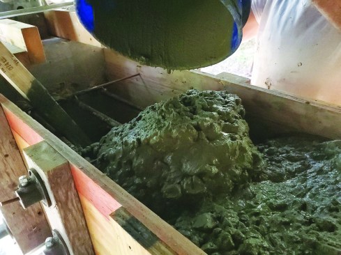

Choose concrete with a 4-inch slump for flatwork.

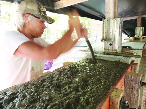

The term “slump” refers to the fluidity or consistency of the concrete mix. The higher the number, the more fluid the mix is. For flatwork, I aim for a slump of 4 inches. At this slump, the concrete is thick but plastic enough to spread and cut even with the form with a straightedge screed. On deeper pours, I use a slump of 2 or 3 inches, which is much stiffer. After placing this stiffer mix, I use a vibrator that consolidates the mix and brings the finer particles in the mix to the surface.
Use a stiffer mix of 2 to 3 inches for deeper work such as this footing.
Consolidate the mix with a vibrator.

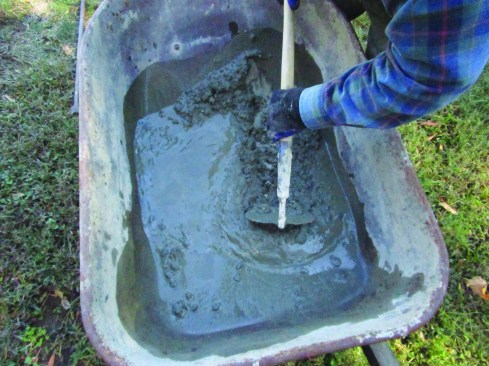

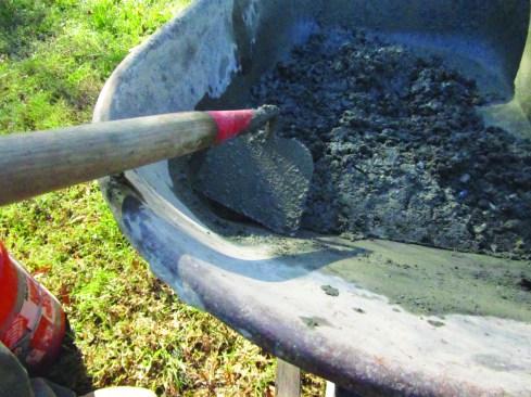

Mixing Concrete in a Wheelbarrow
It’s not always worth the time and effort to tow my mixer to the site and set it up. On very small pours, it’s often easier to mix the concrete by hand in a wheelbarrow. Mixing by hand is hard work, but there are a couple of things that make the job easier and also help produce high-quality concrete.
For wheelbarrow mixing, measure water more precisely.

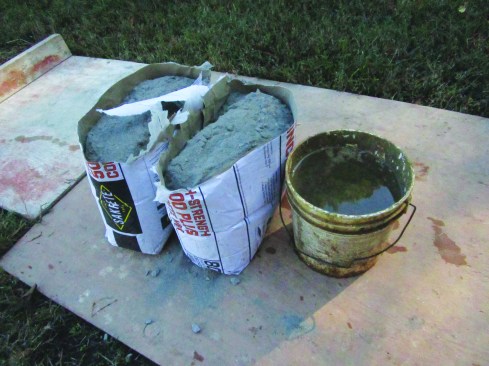

The first thing I do is to measure the water more carefully than I do with the mixer. For an 80-pound bag of concrete, manufacturers recommend using three-and-three-quarters quarts of water per bag. But I’ve found that this ratio makes very stiff, zero-slump concrete, which can be difficult to place and finish. Instead, I use four quarts (a full gallon), which makes very good concrete that is easy to work with.
Mix all the water with half the dry mix.
Then add the second half of the dry mix for the proper consistency.
To mix the concrete, I cut a bag in half as before and dump a half-bag in a wheelbarrow. I add the entire gallon of water and mix the dry concrete into it, creating a soupy and fluid mix. Then I add the second half-bag to the soupy mixture and mix it thoroughly with my hoe. The result is an excellent low-slump concrete. If I need to increase the slump, I can add water sparingly. But I’m careful not to overdo it; too much water weakens the concrete.

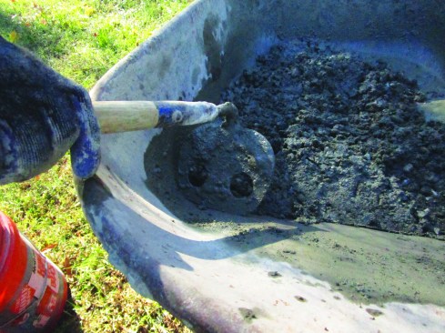

For mixing concrete in a wheelbarrow, a conventional hoe doesn’t work well, because its square corners don’t fit into the corners of the tub.
A mortar hoe has rounded corners and holes in the blade for easier and more thorough mixing.
The second thing I do is to mix the concrete with a hoe called a “short-handled mortar hoe,” which has rounded corners. A regular hoe has trouble getting into the corners of the wheelbarrow, where dry or unmixed concrete tends to accumulate. Because of its rounded corners, the mortar-hoe blade fits much better. The holes in the hoe let some of the mix pass through for less resistance as you stir the mix, and the short handle makes it much easier to handle the hoe while mixing concrete at wheelbarrow height.
