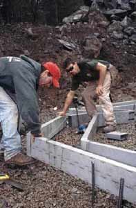

Like many sites around here, the lot shown in the photos has ledge just below the surface. After blasting and excavating, we typically bring in some crushed stone to level the bottom of the hole and create a capillary break under the foundation.
The first step in setting the forms is to stake the foundation corners and run strings between them. We measure off the string, 4 inches for the outside form and 12 for the inside form. Starting at one of the footing’s outside corners (usually the one with the two longest walls), we drive a couple of rebar pins into the ground, one at the inside and one at the outside of the corner.
We then make up two corner assemblies, each consisting of a length of Form-A-Drain attached to a corner piece. We make up one for the inside and one for the outside, making sure the drainage perforations are facing out. The corner pieces have knockout holes that allow us to slip the assemblies over the pins. This holds the corners in place while we’re getting started.
Setting the Forms
Next, we connect the 12-foot lengths, using slip couplings and drywall screws. You can cut the plastic with a handsaw or recip saw, but we generally use a circular saw because it produces the fastest, cleanest cut. Special blades aren’t required — we just use inexpensive abrasive blades from the lumberyard.
