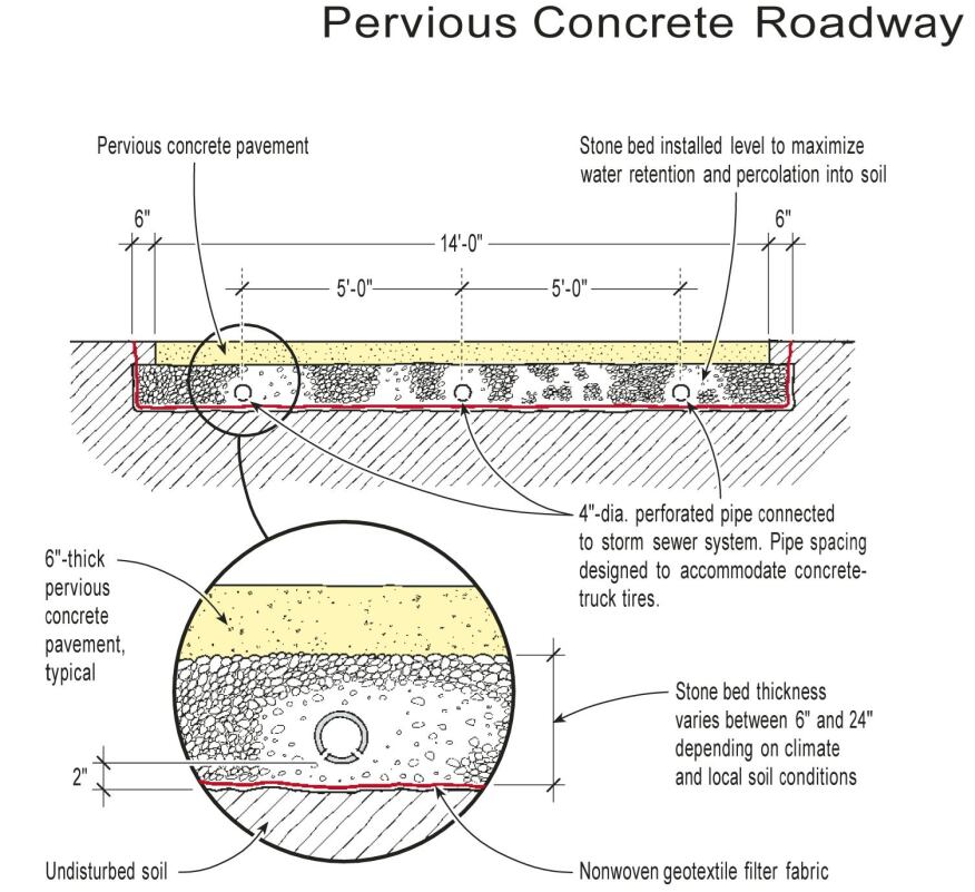

The logistics of making pervious concrete are tricky. For this highly porous concrete to provide a durable surface, the mixture must contain an exact proportion of aggregates and water plus special chemical admixtures, be properly mixed during delivery, and be expertly placed. Pervious pavement is not so much a concrete product as it is a paving system consisting of soil, subgrade, and — of course — the mix.
It's not a job for amateurs, so to build my pervious alley I hired one of the best paving contractors in my area, Constructors Inc. For technical help I turned to the Nebraska Concrete and Aggregates Association. And the largest ready-mix supplier in Nebraska, NEBCO, offered its labs to help develop a climate-appropriate mix. NEBCO employees even poured an experimental test patch at the plant to make sure everything would go smoothly on my site.
Subgrade prep. Since water drains through pervious concrete, it must have somewhere to go. Pervious concrete can sometimes be laid on grade when placed over sandy soils, but most soils require a gravel bed of at least 6 inches thick; this bed acts as a drainage plane that holds the stormwater as it slowly percolates into the soil. In my area — where the soil is high in clay and water freezes in winter — we wanted to be sure that any moisture in the concrete would immediately drain, so we overexcavated the subgrade by 12 inches. We rolled out a layer of nonwoven geotextile against the soil to prevent the gravel bed from becoming silted with mud, then put down 10 inches of clean, lightly compacted No. 57 stone (1 1/2-inch to 3/4-inch crushed limestone).
For insurance, we also installed three rows of French drains that connected to the storm sewer system. If unusually high precipitation causes the thick gravel bed to flood, the storm sewer will serve as an emergency overflow valve.
While conventional concrete is always pitched to drain, the gravel bed under pervious concrete must remain level to maximize water retention and percolation into the soil. In our case, this requirement was an advantage, since we were having trouble establishing a water-shedding grade for our 400-foot-long alley. Using pervious concrete, we were able to pour the road low and level and still manage surface flows from adjacent driveways and lawns.

A climate-suitable mix. A typical yard of pervious concrete contains coarse 3/8-inch (pea gravel) aggregate, six or seven sacks of portland cement, and water in a water-to-cement ratio of .25-to-.30 (which is about a third drier than standard concrete). Because of the low water content, pervious concrete is a difficult mix to work with: It can't be pumped, it doesn't pour out of the truck or spread easily, and its high porosity allows air to get in and hydration to take place quickly. To combat these characteristics, concrete designers include admixtures to slow hydration, stabilize the mix, and provide a slightly longer working time. Even so, a pour must be placed, finished, and covered within 20 minutes.
On this job, the admixtures included air entraining agents. These chemicals add microscopic air pockets to the cement paste so that moisture has a place to expand, which prevents cracking in freezing temperatures. To improve workability, water reducers and viscosity modifiers were added, too. The objective was to have a practical mix that was relatively easy to place and that would yield a pavement with a 15 percent to 20 percent void structure — somewhat resembling a rice cake.

By the yard, pervious concrete doesn't cost much more than conventional concrete; in fact, since there's no finishing involved, it's a little cheaper to install. With no floating, finishing, edging, or cutting, my paving contractor was able to install our 14-foot-wide by 400-foot-long strip in about four hours. On the other hand, we found that the extra site work involved in building the drainage bed almost doubled our overall project cost.
