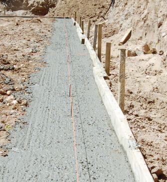

Choose your foundation. That said, I don’t use wood foundations everywhere. I work in more than 40 Michigan counties, and I use conventional concrete foundations more often than not. Although the cost of a PWF is comparable to that of a poured foundation, it’s a better value if the basement will be used as living space, thanks to the ease with which a wood foundation can be insulated and finished. PWFs are especially good on sloping lots where there’s a walkout area toward the front of the structure.

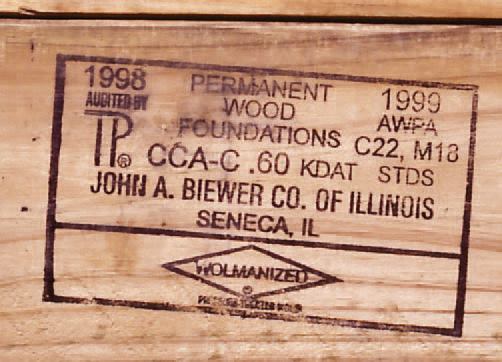

You can’t use just any green-tinted lumber for a PWF. Lumber and plywood meant for use in foundations are engineered specifically for that application, and each piece should be clearly marked as such. The grade stamp should also specify a preservative retention of .60, indicating that each cubic foot of material contains .60 pound of preservative. Southern yellow pine is the most commonly used species in PWFs because it accepts preservatives readily. Pressure-treated dimension lumber follows the same grading system as ordinary framing lumber. We ordinarily use a No. 2 grade for foundation framing.

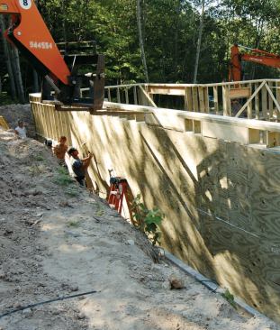

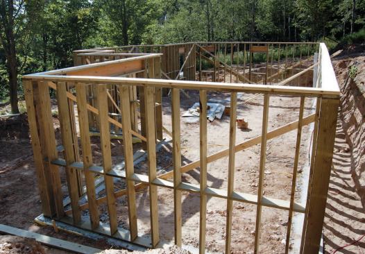

The design guide typically calls for deeper and more closely spaced framing members than you’d find in an above-grade wall. For example, a 9-foot basement I built recently – 2 feet of which was above grade – was framed with 2x8s spaced 16 inches on-center and sheathed with 3„4-inch foundation-grade plywood. Foundations that will be backfilled to a depth of 86 inches or less can be designed with the prescriptive specs in the guide, but deeper walls will require an engineer’s stamp. Load paths. A key difference between a wood and a concrete foundation has to do with how each accepts point loads: In a concrete foundation, a point load that falls within a wall – from a structural ridge, for example – can be transmitted to the mudsill wherever the load-bearing vertical member happens to end up. But because a treated wood foundation is essentially just another studwall, the load path in a PWF has to remain continuous all the way to the footing at its base. These loads should be accounted for and called out on the plan to make sure they are properly transferred to the footing. Depending on the load, it may be necessary to beef up the section of footing beneath the point load.
Shear walls. Most buildings that have a front-to-back grade differential of more than 4 feet will need at least one internal shear wall to resist the lateral thrust from the uneven soil pressure. In structures from 24 to 48 feet wide, the shear wall must be located in the middle third of the basement. Buildings more than 48 feet wide will require two shear walls, which must be no farther than 24 feet from one another or from an end wall.
An internal shear wall can often be omitted where the grade differential occurs between the shorter sidewalls, since the long exterior walls that connect them often provide adequate shear resistance in themselves. The SPC design guide provides detailed shear-wall nailing requirements for a range of situations.
Whenever shear walls will be required, it’s important to work out their locations during the design stage, because they have a big effect on the quality of the living space. The goal is to come up with a floor plan that allows the shear walls to serve as useful partitions rather than obstructions.
