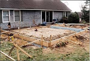

First, the excavator scrapes the topsoil and digs the perimeter trench, sculpting the sides to form a thickened edge and allowing for a 12-inch base of compacted stone or sand.

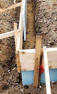

Next, we form the slab with 2x12s, using wooden stakes and braces to hold the forms in place and keep them steady. In our zone, we attach 1-1/2-inch-thick extruded polystyrene insulation to the inside of the 2x12s, securing it to the forms with roofing tins and 8d nails or 2-1/2-inch Plasti-Caps. We nail every 12 inches or so, keeping the nails within a few inches of the top surface of the foam so that we can cut them off later with a recip saw. We use the full 2-foot width of the rigid foam, because this allows us to maintain the proper elevation above grade and gives us enough material below grade against which to backfill.
Insulated formwork.Two-by-twelve form boards are lined with 1-1/2-inch-thick extruded polystyrene insulation board. The author digs the footing trench a full 24 inches deep (right) to make use of the full width of the foam board insulation. Be sure when you order foam for an FPS slab that you specify a high-density board suitable for use under a slab. We use Dow Styrofoam brand, but several other brands are available.
