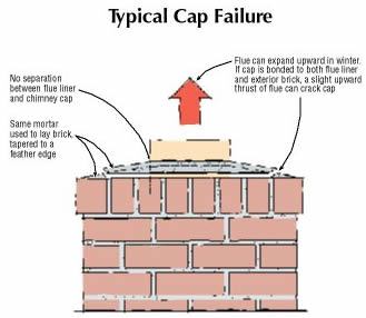

Why Caps Fail
There are four reasons chimney caps fail: First, the cap is the most exposed area of the chimney and the only horizontal surface. It's therefore more likely to absorb and collect water than any other part of the chimney (assuming the roof flashing was properly installed).
Second, masons usually make the cap out of the same mortar used to lay the brick. That mixture is too wet for the cap, which is often 2 or 3 inches thick as it rises toward the flue. As a result, shrinkage cracks often develop before the mortar cures.
Weather has worn away the thin edge around the perimeter of this cap and numerous cracks have formed.
Third, masons often taper the mortar to a feather edge along the perimeter of the chimney. Over the long haul, that edge is too fragile for the harsh environment into which it's placed, and it invariably wears away, leaving a flat surface that collects water.
Fourth, masons rarely isolate the cap from the flue liner. Like all building materials, brick, mortar, and flue liners expand and contract in response to temperature changes. In the winter, when the furnace is running and the family is most likely to build and maintain a fire, the flue can expand upward. The cap is exposed to freezing cold and bonded to the exterior brick. If the cap is also bonded to the flue liner, a slight upward thrust of the flue can crack the cap.
All four of these problems allow water to enter the cap. Over the years, the cap deteriorates and a downward cycle develops: With each winter, more water enters the top of the chimney and causes more damage to the cap. Eventually, water flows into the chimney and makes its way into the house — sometimes in large quantities.
