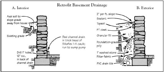

If you opt to do the work on the inside, consider using channel drain — a PVC or fiberglass enclosed gutter with holes in the top, such as Microchannel (NDS, 3001 Mission Oaks Blvd., Camarillo, CA 93011; 805/389-6700). It’s best to embed the channel in the slab, but you can install it over the slab with satisfactory results. Drill holes in the back of channel drain and embed the channel in a thick bead of caulk, as shown in Illustration A, below. Etch the slab with muriatic acid before applying the caulk. I use Sikaflex-1A sealant (Sika Chemical Corp., 201 Polito Ave., Lyndhurst, NJ 07071; 201/933-8800), which sticks well, even under the harshest conditions.
An interior perimeter drain can be fashioned from PVC channel drain (left). First, etch the slab with muriatic acid, then caulk the drain in with Sikaflex-1A. An exterior drain (right) works as well, but is difficult to retrofit if existing landscaping limits access.
As for outside options, there are essentially two approaches. The most expensive way is to install a system such as Enkadrain (Akzo Industrial Systems Co., P.O. Box 7249, Asheville, NC 28802; 704/665-5050). Or you can install foundation-grade poly and 1-inch rigid polystyrene insulation against the foundation. In both cases, you have to lay a foundation drain at the base of the footing in a gravel bed, covered by a geotextile fabric, and then backfilled with a coarse, well-draining soil to within a foot of the final grade (Illustration B, above). Finally, top this backfill with native soil as described below.
