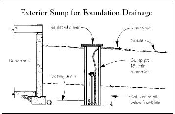

Q. Should an exterior perimeter drain be connected to an interior drain and sump pit?
A.Henry Spies responds: It’s not a good idea to bring exterior water into the structure. Whenever possible, a ” daylight” footing drain should be installed.
If a daylight drain is not feasible, I’d recommend installing a sump pit on the exterior of the house. Locate the bottom of the pit well below the frostline (which is where the perimeter tile along the footing should be), and top it off with an insulated cover to prevent freezing (see illustration, next page). The pit should be at least 18 inches in diameter to allow room to install and service the pump.
Since it’s easier to install a sump and pump in the basement than in an outdoor pit, many builders do bring the exterior footing tile inside the foundation. If an exterior drain is connected to an interior sump, some form of backup pump should be installed. This can be a second line-voltage pump and a generator, or a battery-powered pump.
