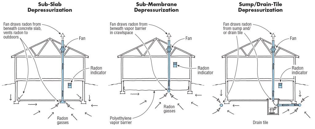

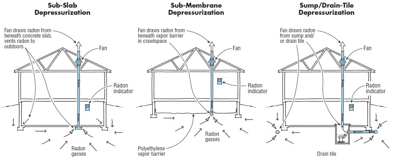

Subslab Poly
The EPA-recommended details for radon abatement call for poly to be placed above the gravel subbase and below the slab. Placing concrete directly on plastic can contribute to slab cracking due to uneven shrinkage and curling. For that reason, consider putting a layer of damp compacted sand above the poly before placing the concrete see Subslab Vapor Barriers in Subgrade and Subbase).
Critical Construction Details
The EPA recommends the following system to prevent radon from entering basements and crawlspaces, and to exhaust radon from below slabs to the outdoors:
  • Subslab: Place gas-permeable layer (4-in. layer of clean gravel).
  • In basements: Plastic sheeting should be placed on top of gravel sub-base and under slab.
  • In crawlspaces: The sheeting is placed over the crawlspace floor.
  • Seal and caulk all cracks, joints, or penetrations.
  • Use 3- or 4-in. PVC vent stack from sub-slab to above roof. Mark this clearly so plumbers won’t mistake it for a drain vent.
  • In attics: Supply a junction box for power in case homeowners choose to install a powered vent fan.
