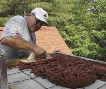

A stiff mix of colored concrete. The next day, I poured the concrete cap. Because I wanted the concrete to blend in with the chimney and the roof, I mixed in a reddish brown dye while adding just enough water to thoroughly hydrate the concrete, so that it had almost no slump. The concrete was, in fact, so stiff that it had to be pushed and pounded into place. But the stiffness prevented it from running over or through the form, and allowed me to form, stack, and shape the cap by hand. Also, because the mixture was so dry, there was very little shrinkage; as a result, no shrinkage cracks developed as the concrete cured.
Dyed to match the color of the roof shingles, the concrete used to form the cap had virtually no slump, which minimized shrinkage during curing and made it possible to push the concrete into shape.
My goal in forming the cap was to create straight, flat planes that rose from each side of the form to a point about 3 inches below the top of the flue liner. I wanted the intersection of these planes to form straight lines, much like the hips on a hip roof. I used hand floats to push the material into place; by lightly rubbing the surface in a circular motion, I was able to knock down the high points and fill in the low points. I used two floats at once to get a crisp line along the hips. At this point, my objective was to get the shape right. I wanted the surfaces to be flat and straight, but because I wasn't trying to make it perfect I did everything by eye.

To create the hips of the chimney cap, the author used two floats. He pushed the concrete into position and smoothed out high and low spots so that the cap would easily drain water away from the flue.
