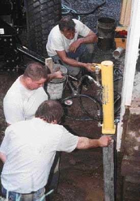

The repair and stabilization plan developed by our estimator called for two support piers to prevent the subsided footing from sinking further and three wall ties to pull the bulging foundation wall back in line.
To stabilize the footing, we use a push-pier jacking system from Grip-Tite Foundation Systems (877/474-7848, www.griptite.com). Hydraulic rams powered by a portable pump push steel posts into the ground until they develop sufficient bearing capacity. At this point, L-shaped brackets are bolted to the post and support the footing from below. The system works in principle a lot like an automotive bumper jack, except the lifting action is hydraulic rather than mechanical. While smaller repairs like this one are more common, we’ve also used the push-pier system to stabilize entire foundations built on poor soil.
