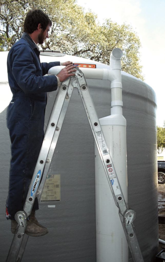

My company installs both potable and nonpotable systems. Nonpotable systems (see slideshow) are most often used to supply irrigation water in areas where municipal water is available; potable systems provide drinking-quality domestic water and are typically installed in place of a drilled well. Both contain the same basic components: a collecting surface (usually a roof), gutters, downspouts, inlet filters, first-flush diverters, and one or more storage tanks. Most systems also include a pump of some sort. In addition, potable systems
