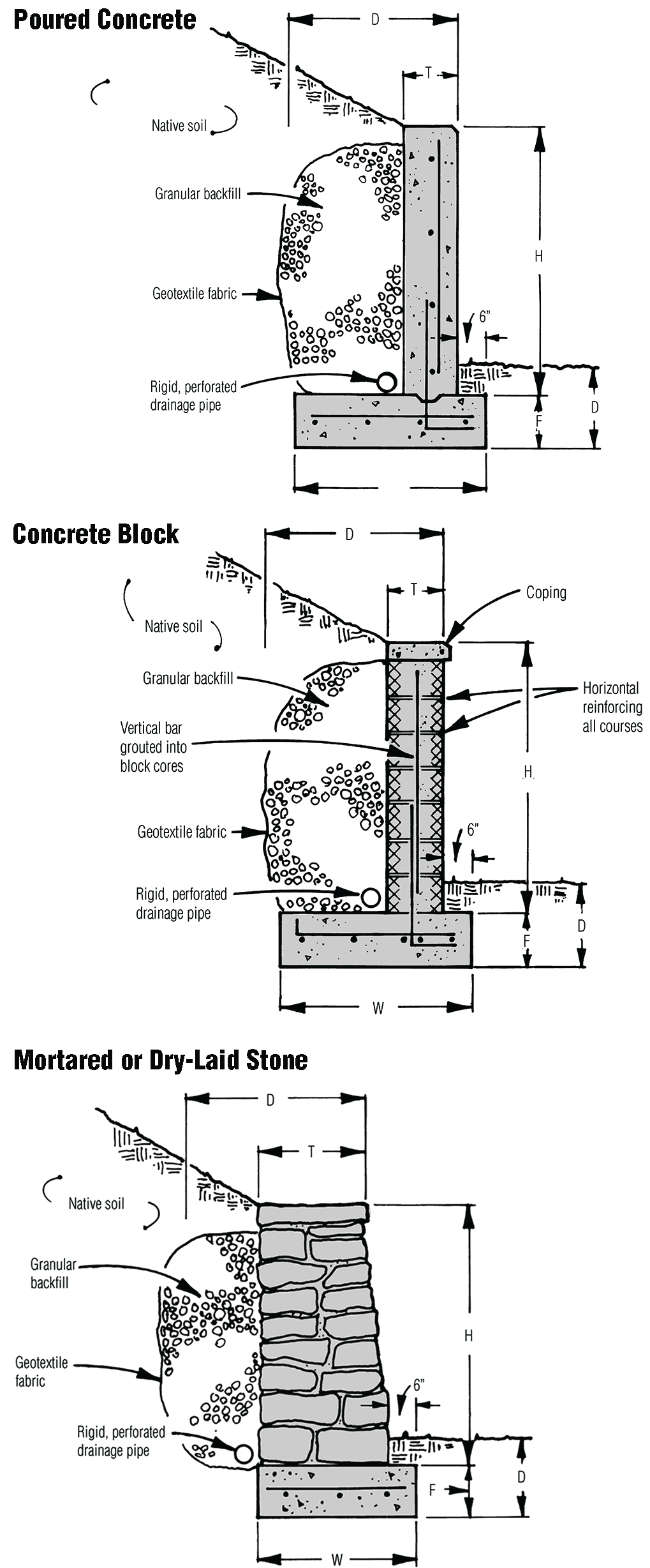

Poured Concrete and Masonry Retaining Walls
For concrete and masonry retaining walls less than 5-ft.-tall, follow guidelines for steel placement and dimensions as shown below. Taller walls should be designed by a qualified engineer.
Figure: Masonry Retaining Walls
Recommended Dimensions for Low Masonry Retaining Walls 1
H W Steel Rebar Bar Spacing F T D
2' 20" #3 (3/8") 2'-0" o.c. 9" 8" Local frost depth or 12" to 18"
3' 25" #4 (/2") 2'-0" o.c. 10" 8"
4' 32" #5 (5/8") 2'-0" o.c. 11" 10"
5' 42" #5 (5/8") 1'-6" o.c. 12" 12"
  1. Suggested details for walls no higher than 5 ft. where dense, coarse-grain soil exists below footings. Not for loose or soft sand, peat, or clay.

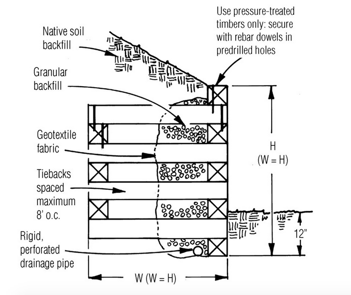

Timber Retaining Walls
Crib walls built out of landscaping ties function like a gravity wall. The mass of earth in the crib structure holds back the pressure of the soil behind it. Wood must be treated against rot. Timbers can be joined with 10- or 11-in.-long, hot-dipped, galvanized spikes or with rebar dowels in pre-drilled holes.
Crib walls can be as high as 30 ft., but a qualified engineer should design walls higher than 5 ft. For walls 5 ft. or shorter, follow the guidelines shown below.
Figure: Timber Retaining Walls
Recommended Dimensions for Low Timber Crib Walls 1
Timber Size Dowel Size Spacing of Tiebacks
6X6 1/2" (#4 bar) 2 6'-0" (max.)
8X8 3/4" (#6 bar) 3 8'-0" (max.)
Tiebacks for Low Walls
For very low timber retaining walls in granular soil, you may be able to use tiebacks instead of an actual crib design (see below). Tiebacks spaced 16 ft. o.c., staggered on alternate courses, are typical. (For greater holding power, space tiebacks closer.) Tiebacks should extend into soil a distance equal to the wall height.
Figure: Tiebacks for Low Retaining Walls
T-shaped timber tiebacks every 16 ft. on each course help to stabilize very low timber walls. In heavy soils, backfill with sand or crushed stone. With new, surfaced timbers that fit snugly together, weep holes or perforated drain pipe is needed to relieve hydrostatic pressure.
  1. Details apply to walls no higher than 5 ft.
  2. In acidic soils, increase by 1/4 in. or use hot-dipped galvanized.
  3. In acidic soils, increase by 1/4 in. or use hot-dipped galvanized.

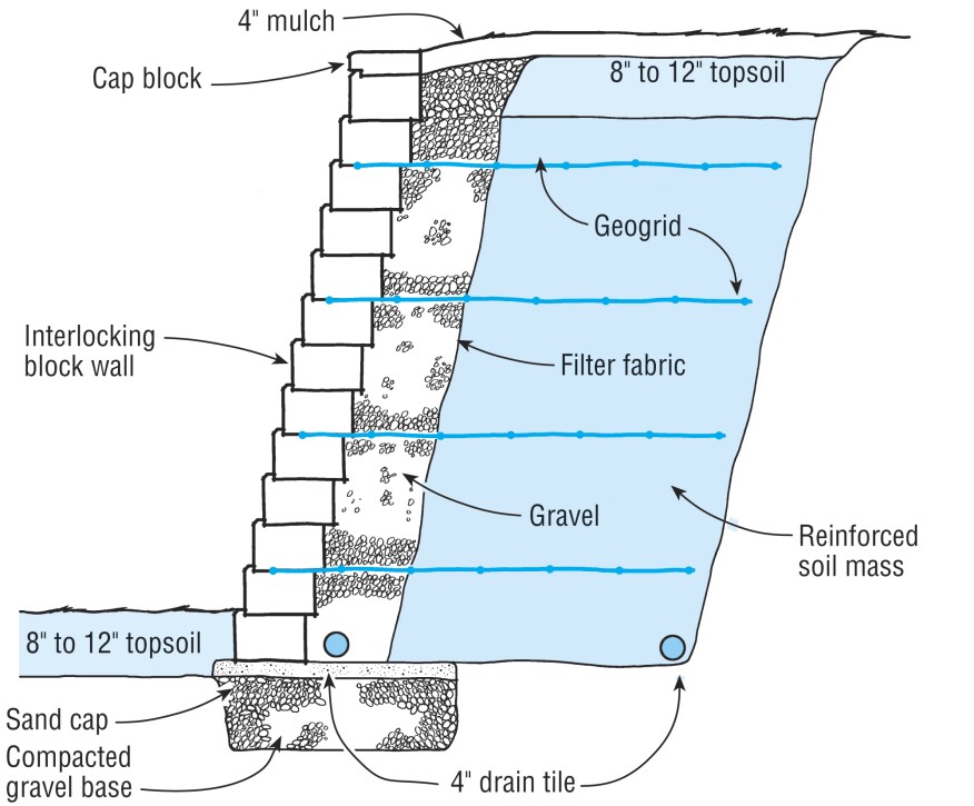

Interlocking Block Retaining Walls
Geogrid is a plastic grid material used to reinforce soil banks. In combination with interlocking block systems, it can be used to create a block-faced earth retaining wall that functions similarly to a concrete gravity retaining wall (Interlocking Block Retaining Walls, below).
Engineered Tall Walls
A qualified engineer should design block walls higher than 5 ft. Usually, the vertical spacing of the geogrid is about twice the depth of the masonry units, and the geogrid extends into the soil horizontally a distance equal to 60% to 80% the total wall height, depending on the surcharge above the wall.
Figure: Interlocking Block Retaining Walls
In an interlocking block wall, geogrid is typically placed on soil layers at 1- to 2-ft. intervals, and the soil is compacted in lifts. Block without geogrid may be sufficient for walls up to 4 ft. in height; with geogrid, walls can be as high as 16 ft. or more.
